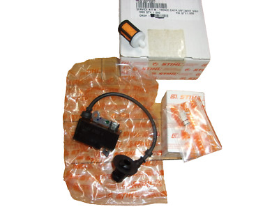

IF you get a coil, get the 661c mtronic update kit. Includes a new coil, filter and solenoid for $20-25 less than the coil

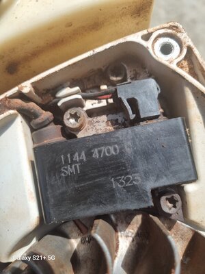

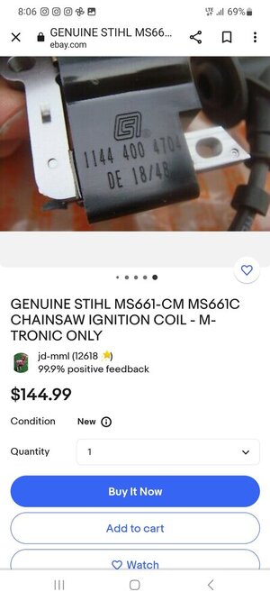

Definitely the coil Sir. Was cutting with it today and it just cut out refused to start back. Then it started once I got home. Do you have a part number for the upgrade kit. Just bought a new carb with solenoid as thought that was prob. This is a pic of my coil. Older one for sure. Think the 1144-400-4704 os the updated coil. 20230315_145725.jpg

Definitely the coil Sir. Was cutting with it today and it just cut out refused to start back. Then it started once I got home. Do you have a part number for the upgrade kit. Just bought a new carb with solenoid as thought that was prob. This is a pic of my coil. Older one for sure. Think the 1144-400-4704 os the updated coil. View attachment 369345
Don’t know the new coil part number but anything below 4700c probably should be replaced as they had a tendency to run lean.
Here’s a kit
