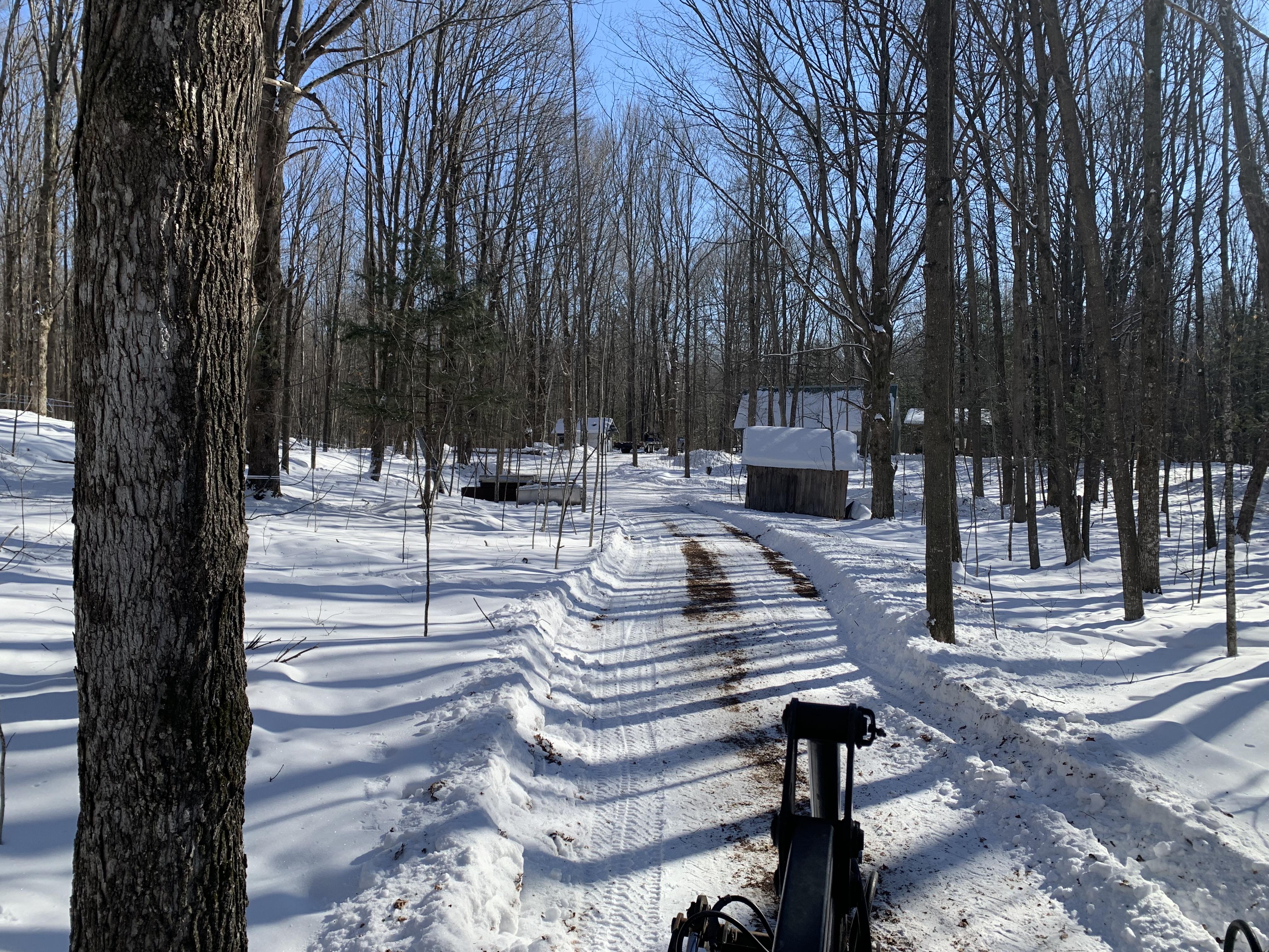

My youngest tagged along last night for the sap collection. It takes a half hour to empty the barrel into the one on the back of my side by side when using the little 12v pump, but that just means time to check lines and goof off.
