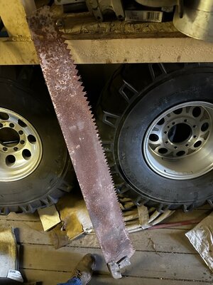

That one may be a lost cause. It may be too brittle to set the teeth. Sharpen a few teeth and then try setting them. They may just snap.
Annealing and retempering is a whole nother thing. Might be a lost art at this point. On old saw I mean. Good luck.

thats a strange one in that the tooth pitch changes from front to back. Never seen that before. around my parts we call those misery whips.
Tuttle tooth with a starter section of plain tooth. Pretty common for firewood saws. The plain teeth are a lot easier to sharpen but don’t clear chips as well.
