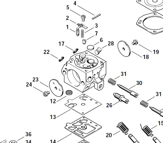

Sounds like the inlet needle is either being pinned open or not seating correctly. Go through the carburetor and check to see
if the metering diaphragm is installed correctly, and if so, if the inlet needle lever is too high. If both of those look ok, check
the inlet needle seat to see if the opening is even. In the picture below, the inlet needle is #1 and lever is #2.

More likely than not, there is something going on with the inlet needle and seat. A quick pressure test will confirm this, should hold 7 psi( .5 bar ) if not...
It's either sticking or a wood booger keeping it from closing or sometimes(more rare) a tip failure. Disassembly will be required to decipher just what goes on.

The flooding issue has been an intermittent problem throughout the 64-73-79 series.
The fix, from the dealer, has often been to replace the oem spring in your carb with the one in the pic below. This usually takes care of it. I keep a few of these on hand for just this purpose. This is advice I’ve gotten from the oldest Dolmar dealer in the country, and they’ve never steered me wrong.

The popoff has been kinda low on a few of these I tested. Even with a brand new kit and spring. The restrictive tank vent design doesn’t help the problem either (tank builds a lot of pressure). I just stretch the spring out juuust a bit more or lower the lever just a tad. Both achieve the same thing. I clean the needle seat with a q tip with toothpaste and carb clean it after. Usually holds 15-20 psi after that. The walbro spring that Sondre mentioned is stiffer, thats probably the easiest thing for you to try first...
