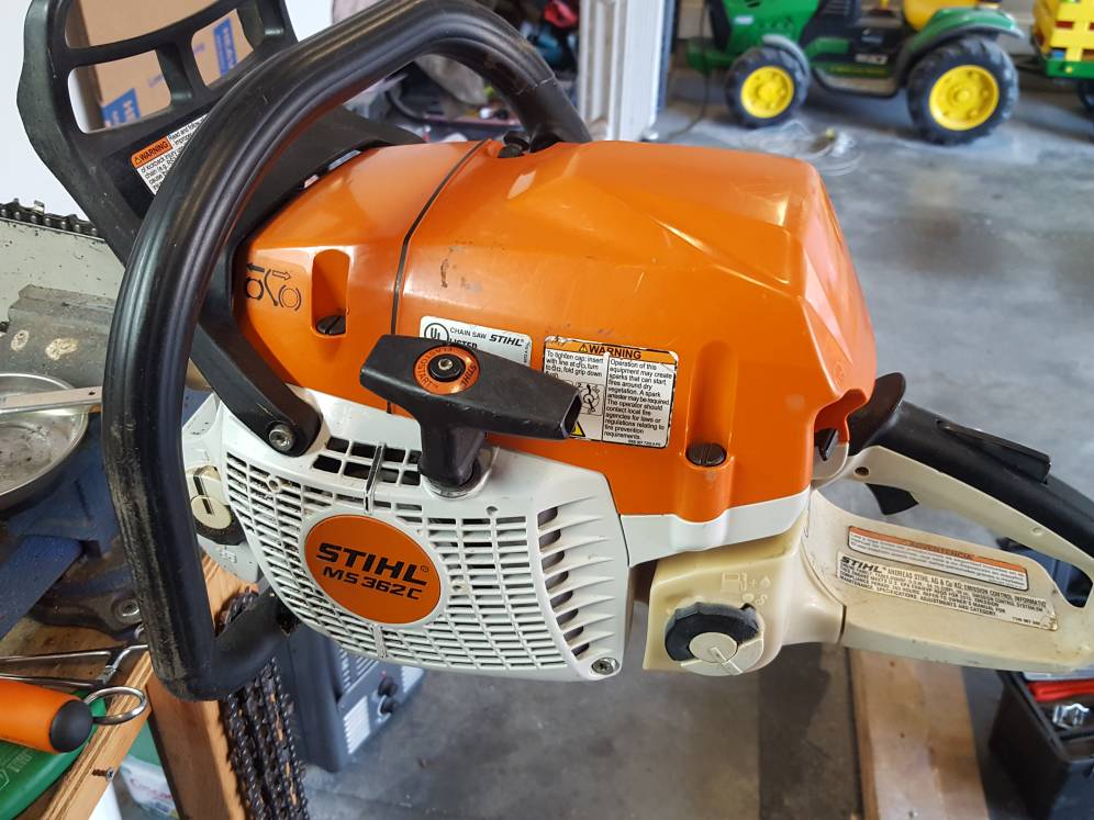

So I just put a top end on a MS362c. Standard procedure I would think would be reset the electronics after the replacement and a few heat cycles.
The procedure for this flavor M-tronic I believe is 90 seconds of Choke/Start position and then shut the saw down with out touching the throttle.
How do I kill the saw with out touching the throttle as the choke position locks multifunction lever until the throttle is touched? I figure the idea is to hold up on the lever and touch the throttle moving quickly to stop with out really increasing RPM much.
MS362c v2
Ideas? Comments? Should I just crush it?
