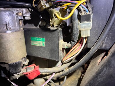

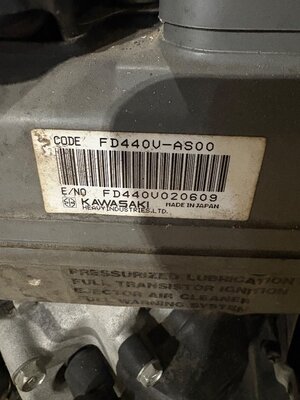

Could you post a picture of the igniter? Most of the FD engines have a 12v supplied ignition without an igniter. FC series is the only one I can think of with an igniter like I was talking about, but this may be a really old FD with a similar setup.

That’s older than any FD I’ve ever worked on. What a weird setup!
I would suspect supply voltage to the igniter. I’m sure it has a 12v feed wire somewhere. Find a mower wiring diagram and do some testing.
