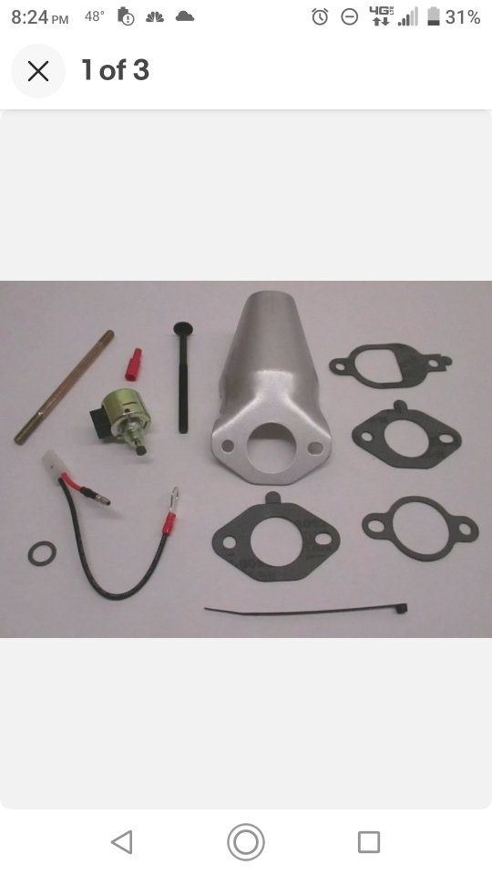

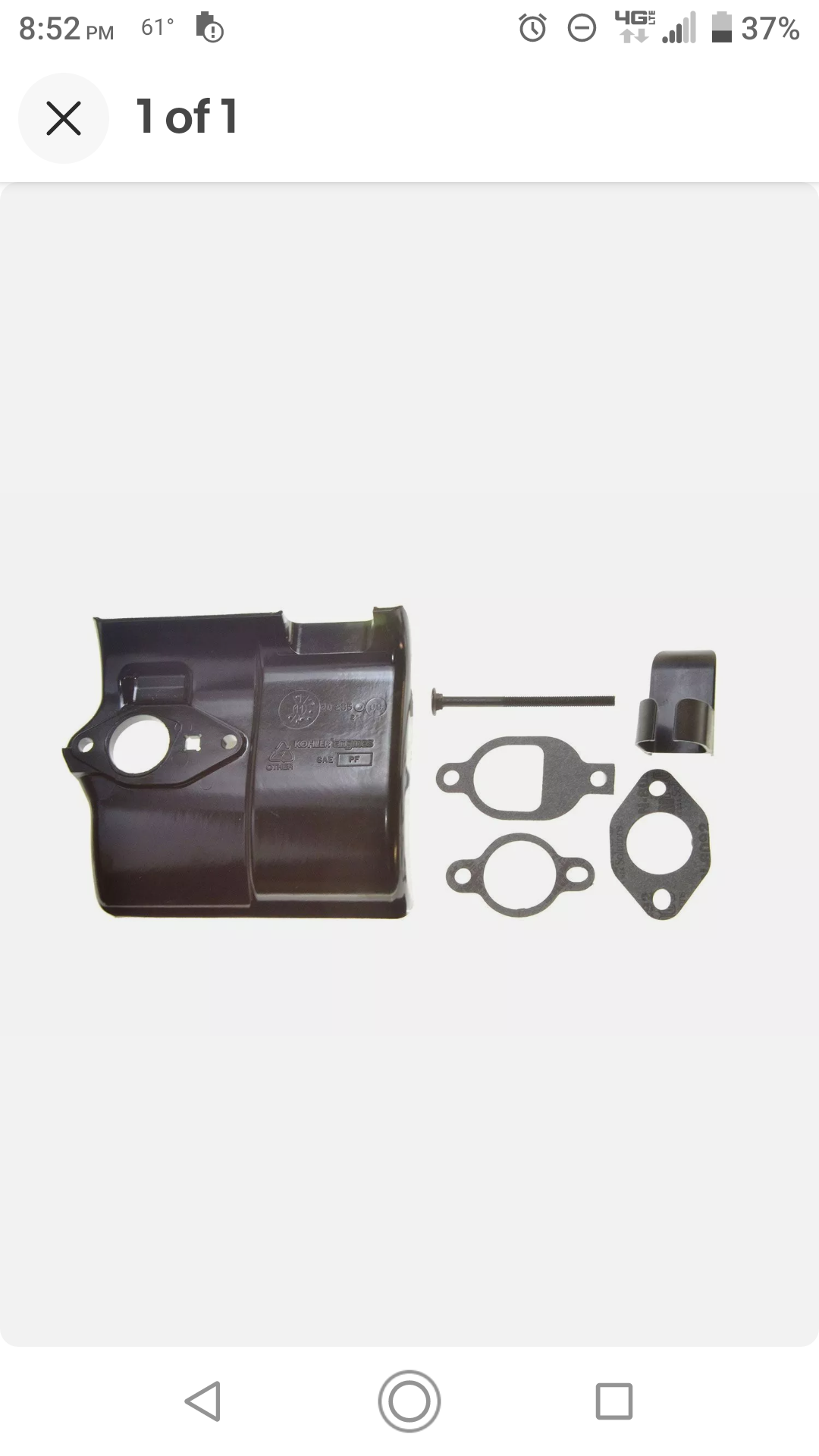

Worked on a Kohler Courage 18 recently on a Troy Bilt rider, oil change, resealed valve cover and rebuilt carb. Something went wrong with the carb rebuild so I replaced carb for her at no cost. Seemed to be okay. She just let me know that it's acting up on her again. Ran fine for a while then started surging badly. Definitely seems to be lean. Any suggestions? I have on order a new heat deflector kit which I'm suspicious of as being the issue. I'm not too well versed in the Courage so I'm working blindly.

I have the 19, I believe, on my cub cadet mower. Removed the backfire nipple and cleaned carb good. Ran well for awhile. Then started surging at idle rpm. I have removed the smaller black plastic piece in your picture, maybe that was the cause of my problems? It is long gone now. And only surges at idle, full power she runs fine. I live with it.

Talked with @Onan18 and he's seen plenty of the heat deflector/intakes cracked. Seems like I'm on the right track with my suspicion.

Finally found the issue
Heat deflector between carb and head is cracked. Have a new one ready to go. Also did some digging and found that there's an update/repair kit for the shutdown solenoid with heat shield for the carb bowl and solenoid. Have that on order.
Thanks to @backhoelover thread a while ago for the bulletin on the solenoid.
Interesting video on the solenoid repair:
