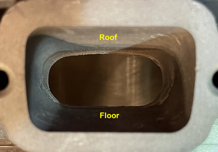

one thing to also be aware of, is sides of ex port. anything beyond just taking the bur off is unnecessary and will lead to the ring getting farther into the ex port and then being more likely to hang on the roof/floor.
this one was too flat btw…

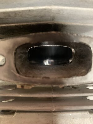

I returned a Cross cylinder for a G660, both roof and floor looked too flat to me. I did not want to take the risk that this would catch a ring and wreck a new saw.

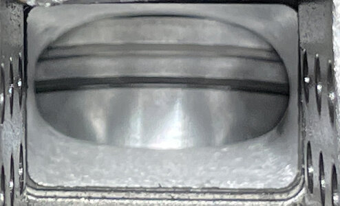

I ported the cylinder the saw came with, runs perfect. I could have gone a bit flatter on this, but I wanted long term reliability out of this one.
It probably would have been fine, I've seen worse run.
See I like the roof on the first picture more seems like it would make more power than the second picture (if only comparing the roofs) but maybe i'm wrong.
Wide flat roof makes better power up high. A more rounded roof won’t be so peaky, lower hp and more forgiving
