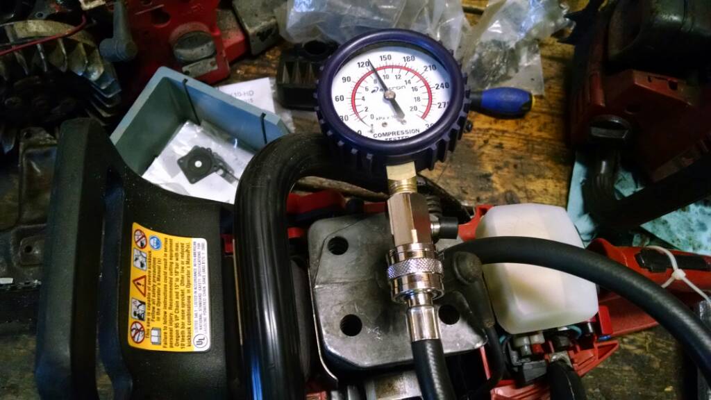

Here buddy this should put your mind at ease. Same saw as you have....disregard the rest of the mess. I have several saws in pieces at the moment.

Thanks so much guys....That's what I was after!...Cheers!
