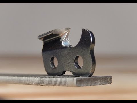

I have seen photos like this, where there appears to be more of a side plate edge. Although, both eliminate the 'shelf' that both Oregon and Madsen's describe in detail.

This profile is very new to me. But I ran across a (French) YouTube video describing it today. Looks like the same image that the still photos above are from.

If you look at factory square the side plate
is straight up and down going clear to the tie strap .It junctions with the top plate in the "working corner " If you "beak " it it might cut faster for a short period of time but will not hold the edge very long . I seldom do any square with the exception of my version of a race chain . It might be a little faster if you are fond of filing which I'm not .
Those deep gullets in round just carry a larger chip before it rocks out which may be faster if you have enough power or slow you down if you don't .That's up to whoever and whatever they have to pull it .
