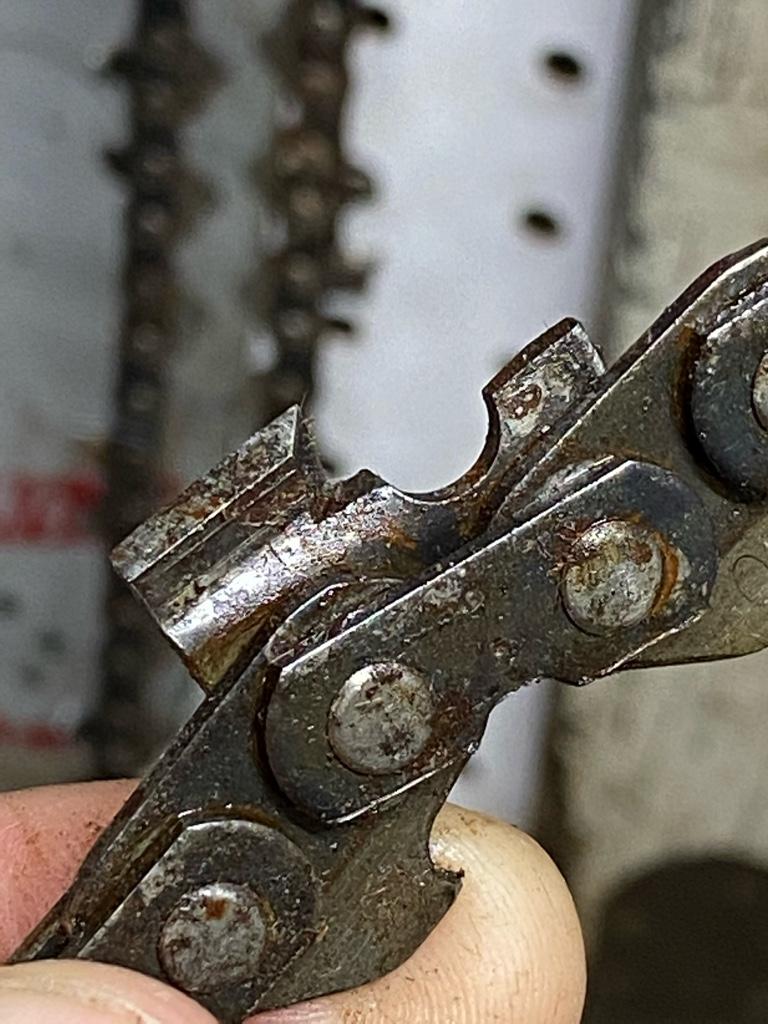

Here is the Ice chain that came off an 090g that I bought.

And it had a grease zerk installed in the clutch cover. The pump grease while the chain is spinning slowly and run no oil when cutting. The grease will stay on the chain snd not sling off in the water.
That looks like square full chisel with the rakers ground off
