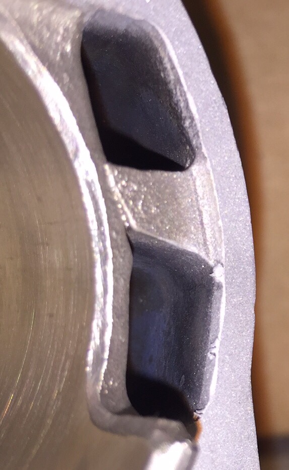

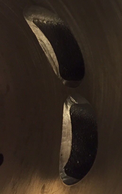

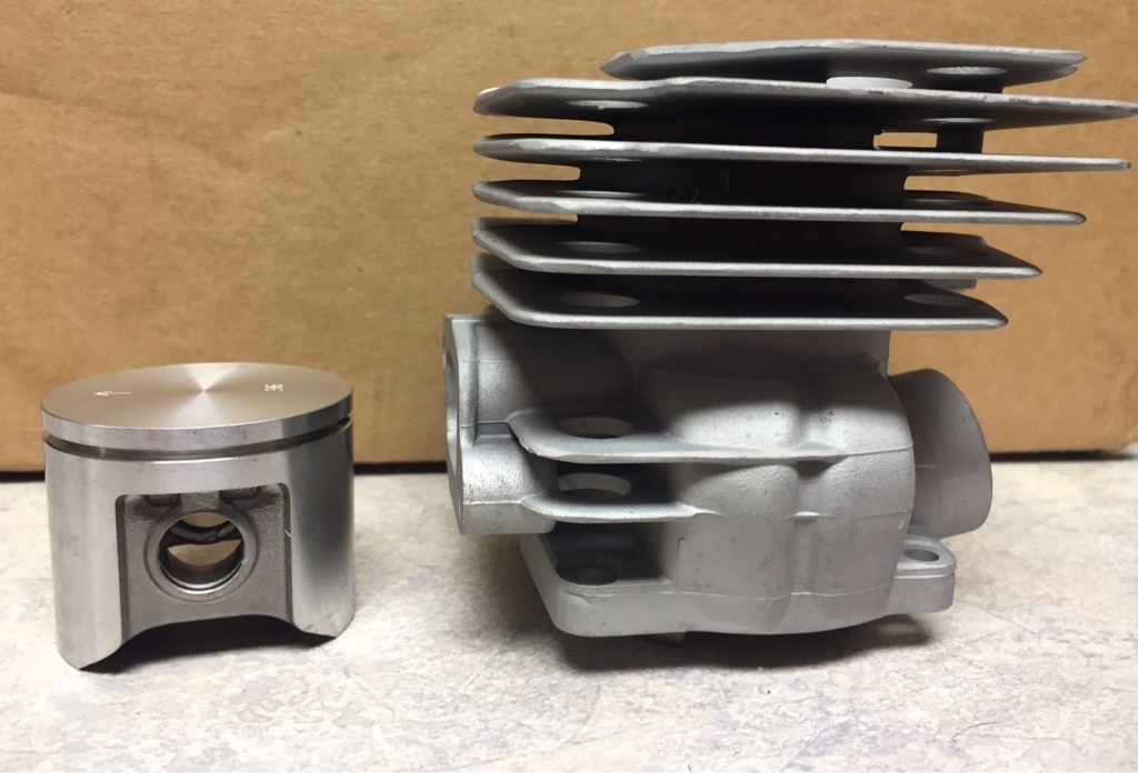

So I know I have seen lots of build threads pop up on here so I thought I would contribute one. I don't know how to do the port timing numbers yet, but will do all I can. Pics first...
Casting looks great.

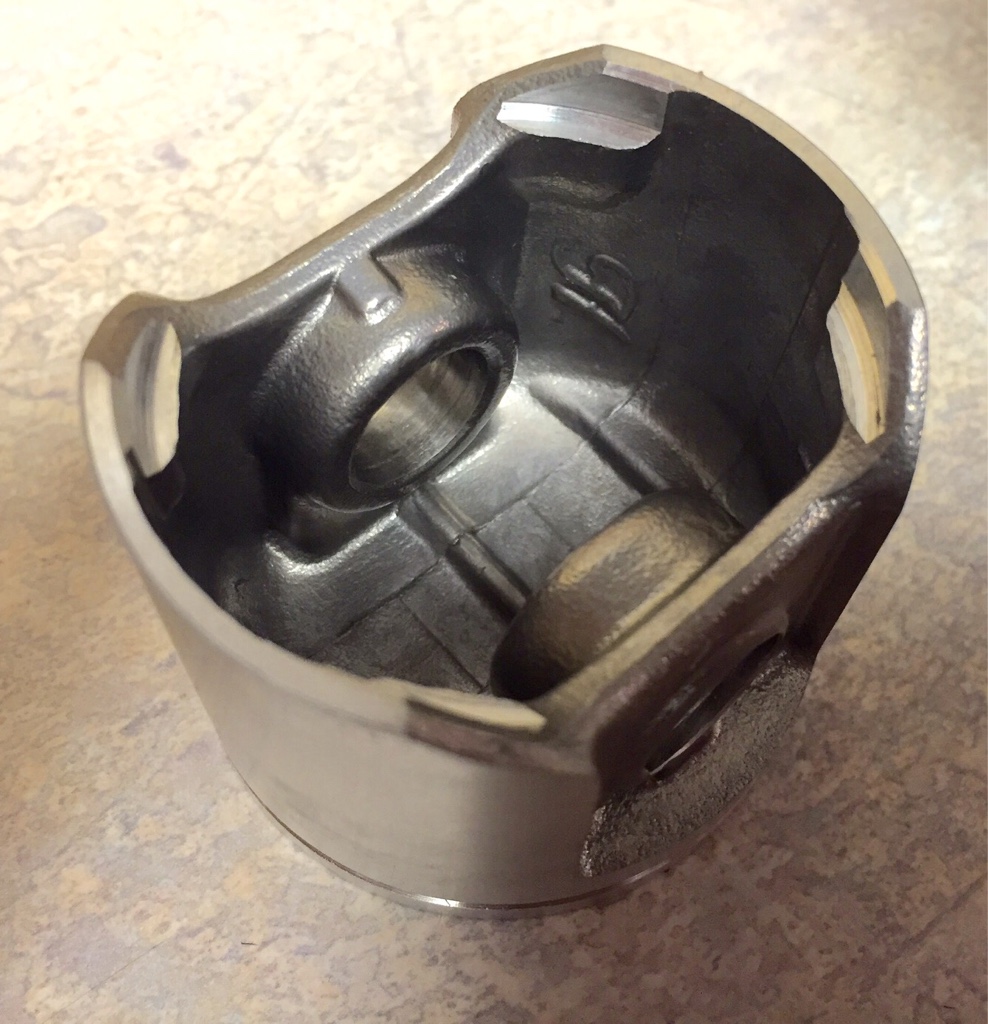

Piston looks really good too.

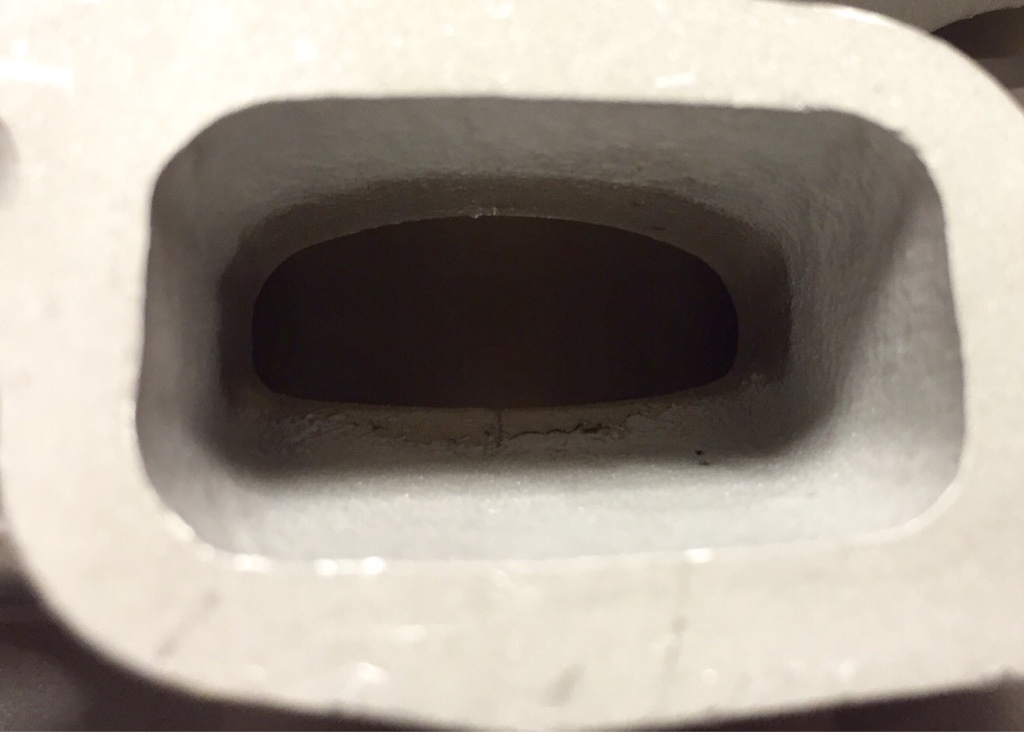

Nice arch to the exhaust and pretty smooth out of the box.

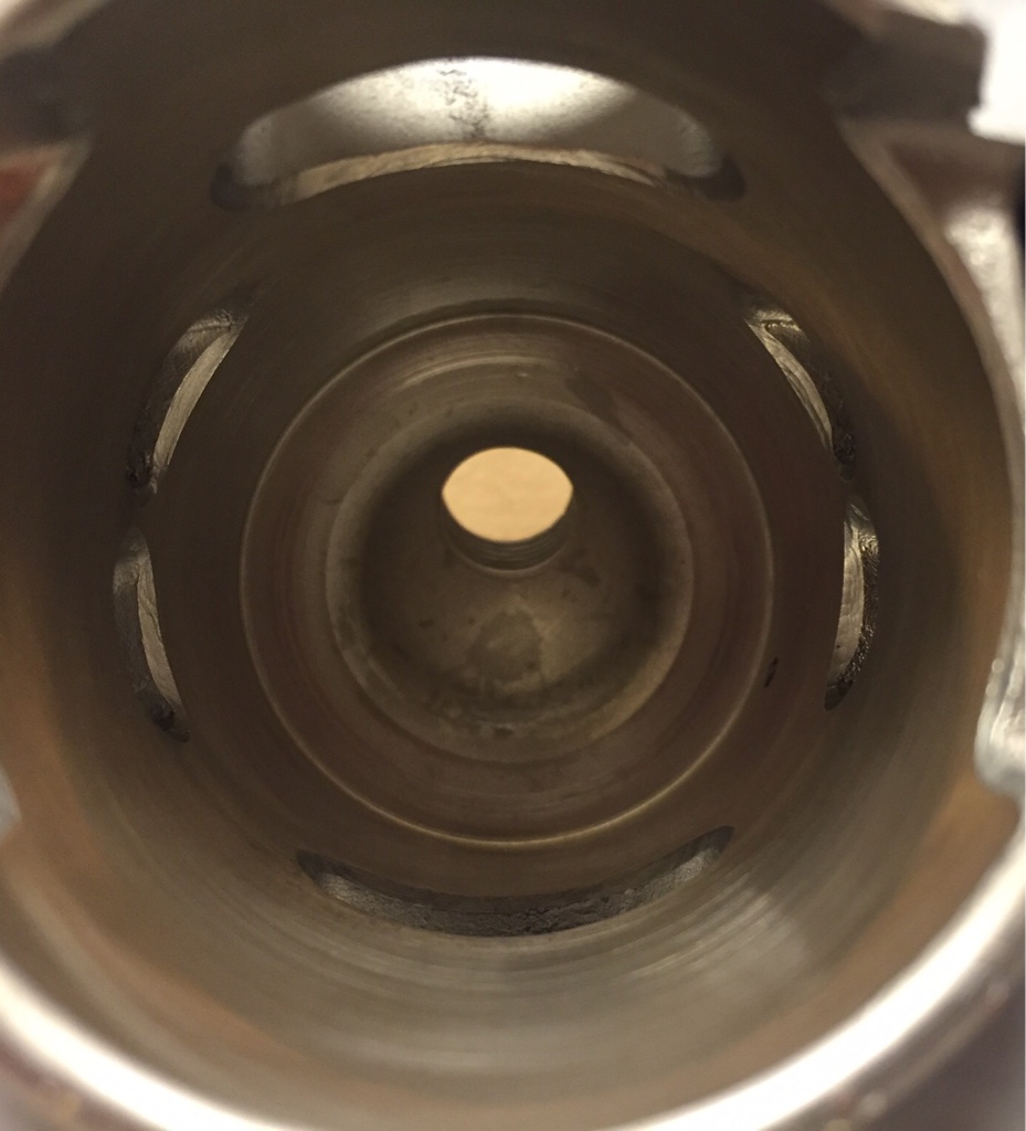

Upper transfers have some pretty heavy beveling. Not bad but probably a hair more than what's needed. Same for intake and exhaust. Better to have it over sharp edges.
Lowers look smooth. Good as is but a little foredom work would improve them.
Cylinder roof looks flat with decent combustion chamber.

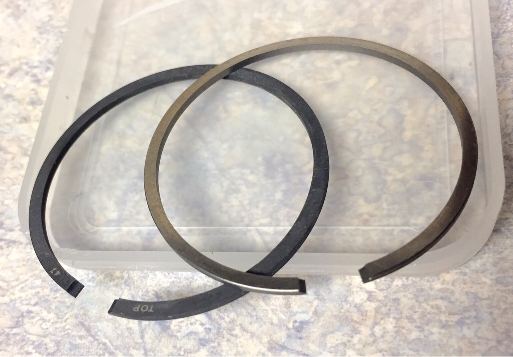

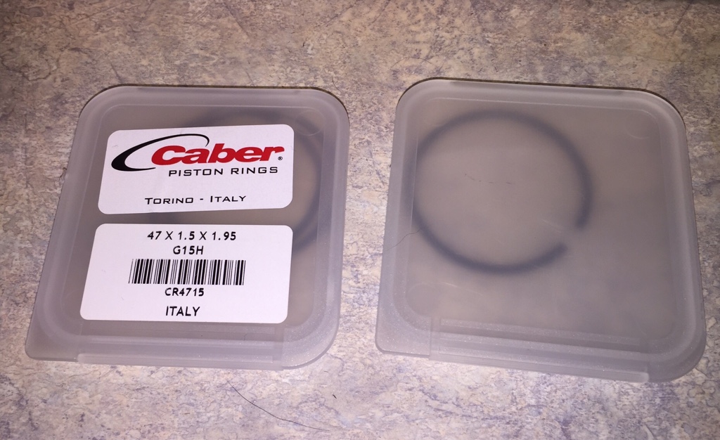

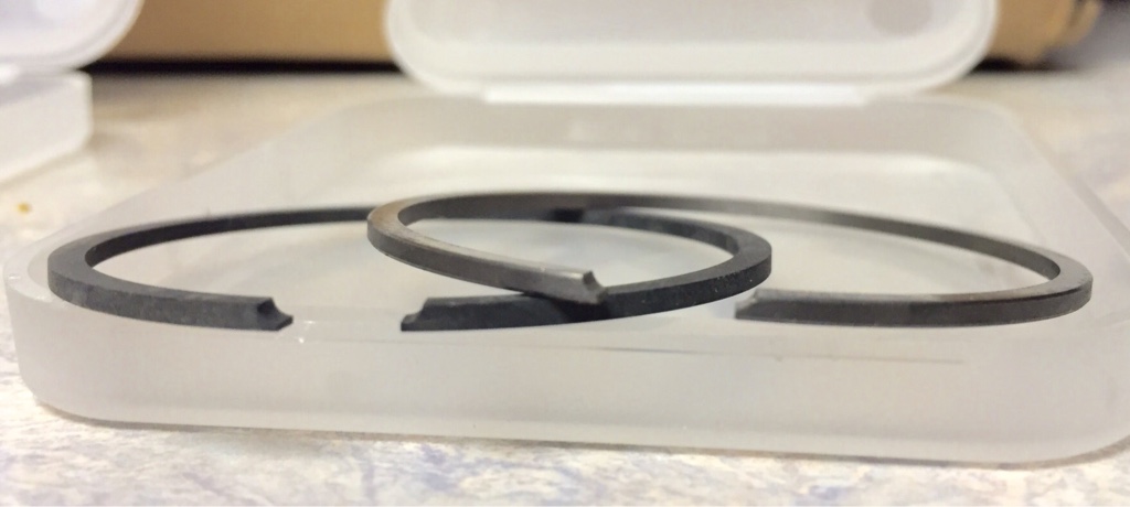

I always use cabers. The boxes look the same but the rings are different. I have done more than a couple hyway kits with the rings in the kits. Initial compression is good on both but the hyway kits have come back more often than not with 20-40lbs less compression and finicky starting problems. Fixed with fresh cabers and not returning.

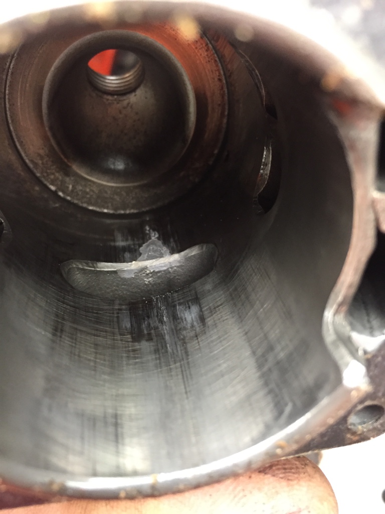

After the sq band cut the plating flaked off when blending the chamber edge.
Also flaked off around the ex & int ports while grinding.

I felt the need to post the latest news on this 359.
The chrome peeled on this specific cylinder. That being said HLS has been very great and has replaced it quickly. I have installed dozens of hyway kits without this problem before. I will reinstall the same hyway 359 top end and we'll see how long the second one lasts. From past experience it seems like a fluke to me but others might say differently.
