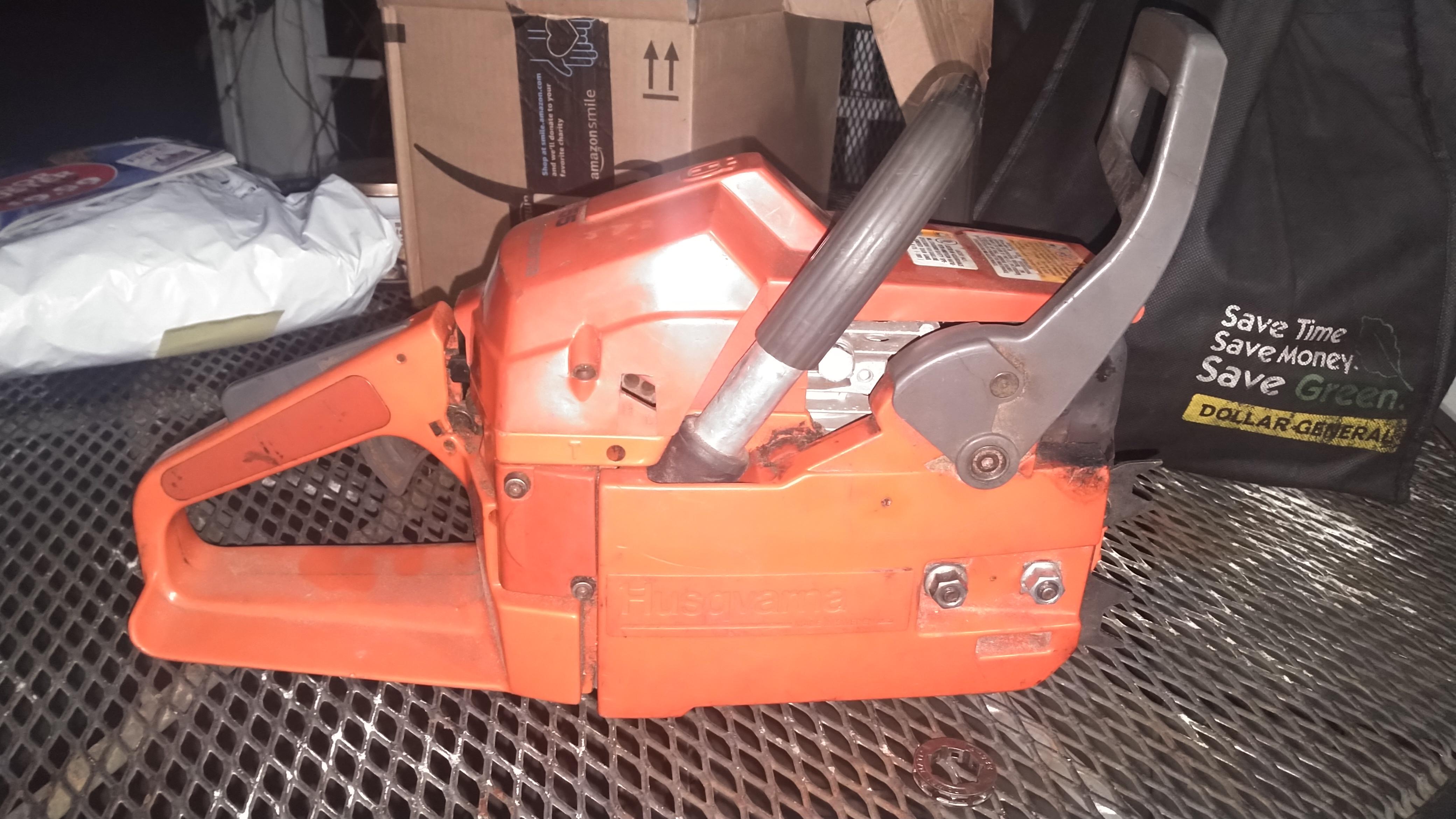

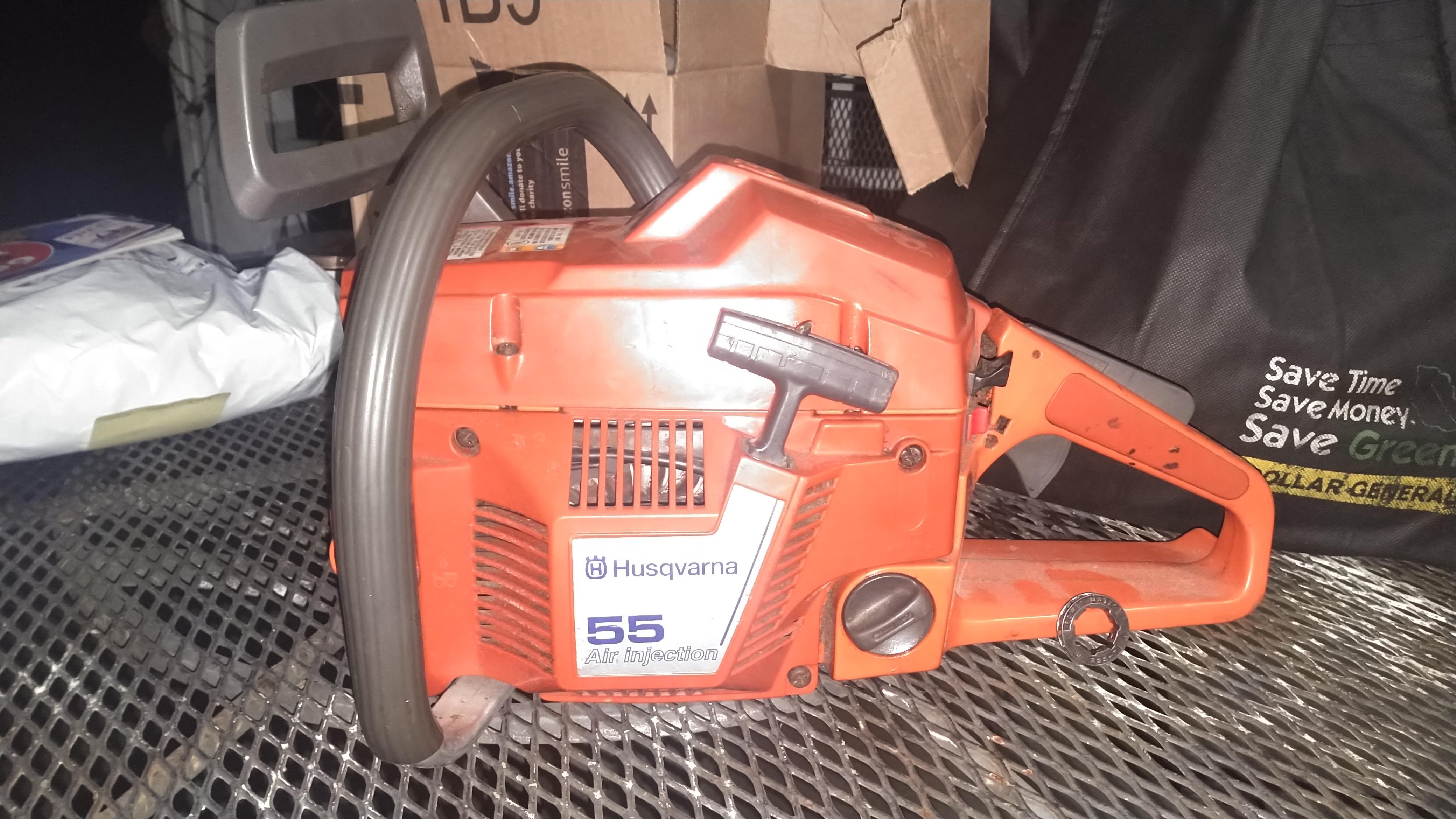

How do I identify an open vs closed port cylinder on a 55 without disassembly?

Most of the time when it has a decomp it is a closed port. I saw a couple later rancher 46 mm open ports that had it. Many after market jugs also have the decomp.
If it’s original and you look at the sticker under the handle bar. It will say husky 55 with 51cc displacement. That’s another clue. Although they made some 51 cc open port jugs too but I’ve never seen a 51cc open port with decomp

Mine is definitely closed port. Pulls damn strong.
