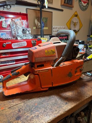

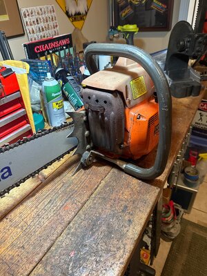

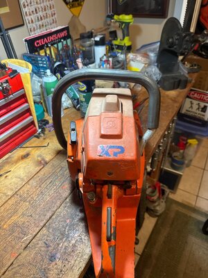

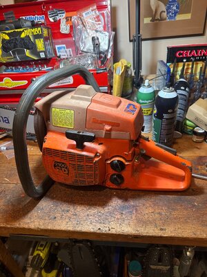

For sale. This saw runs good except for the carburetor. It’s worn out. You can set the needles where they need to be and the saw runs great for about 20min. Then the idle speed screw and the idle mixture screw back out making it so rich you can’t keep it running. It’s a shame too. The saw cuts like crazy.
I replaced the crank seal on the pto side and realized it needed another seal behind the clutch to cover the oil pump. Haven’t done that yet. Also, the manual oil pump will stick after sitting but comes to life after one massive hard push. It’s missing one of the internal tits holding the air cleaner cover on, but it’s secure and one of the holes for the top cover is wallowed out.
That’s about it. Like I said, when you get it all going at once, it’s an awesome saw. Vintage heavy iron.

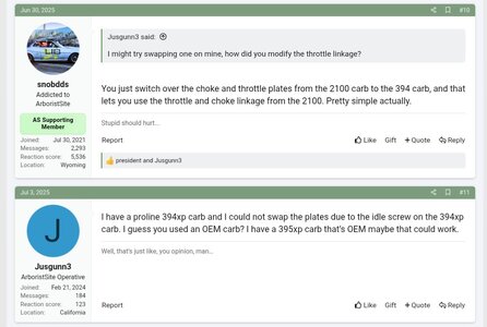

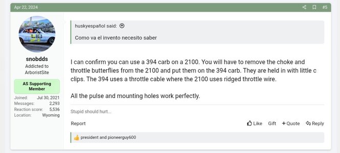

I made the mistake of trying to swap over the throttle/choke plates onto a 394xp carb without staking them… Screw right down the intake and into the cylinder. Make sure you stake them or maybe threadlocker if you do swap them.
Sloughfoot
7:44 PM
26879
Jun 7, 2023
1,901
5,522
Norcal
I think a 288 carb will also work, I had an aftermarket one I gave to @Sloughfoot for his 2100, can't remember if he was able to use it on his or not.
Yep. Just gotta swap one of the butterflies off the factory carb so it'll hook up to the linkage. Throttle I think.
