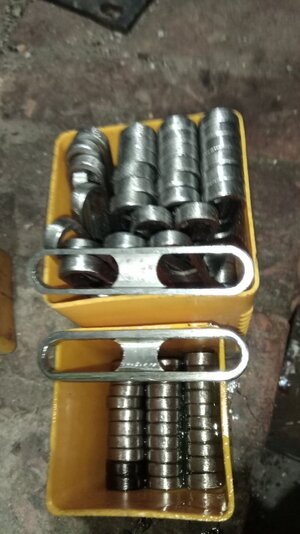

I have one from Red Beards & one from Saw Suppliers, fitment is great for both. I always worry about losing the damn things though.

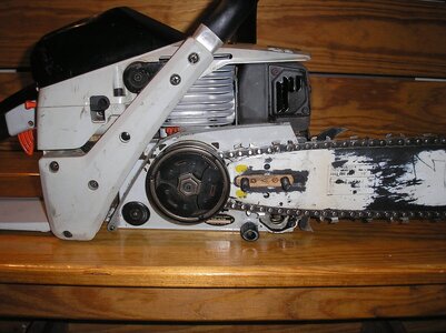

you'll have to drill the bar tensioner holes to a larger size and elongate the stud slot to run a stihl bar on a husq.
