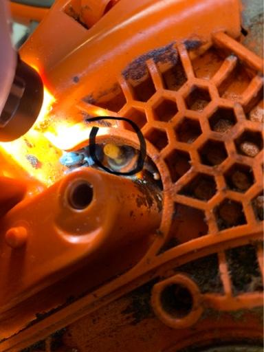

Where is it? I can’t find it. [emoji90]
Only thing left that could be causing the problem.
Cut three 16-18” cookies showing no mercy and the thing dies coming out of the last cut. Restarts at idle after a moment.
Cleaned carb, new fuel filter and purge bulb. Fuel lines in ex shape. 150 psi. [emoji106]

Just looked behind the bottom right of the wrap handle. It wasn’t there. But fuel leaked from somewhere in the right hand side. Screw holes? IDK.

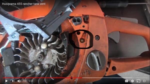

Ronie
9:14 AM
5495
Mar 2, 2018
2,668
9,008
NC
Pulled from a video

I see nothing in there.
Shot some carb cleaner in just in case tho.

Found it!
Plugged up solid won’t pass carb cleaner under pressure.
