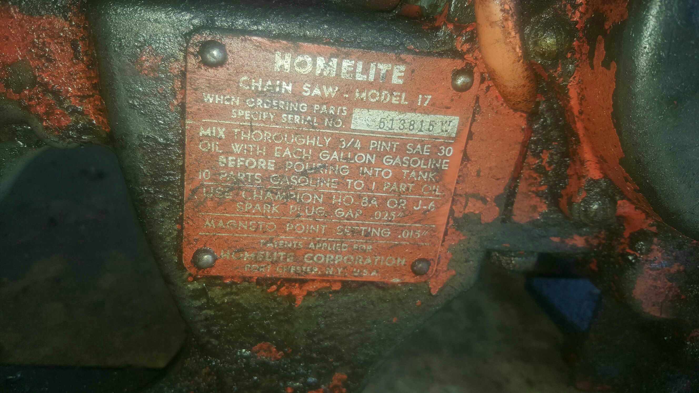

Should be a metal tag on side. Might have to scratch paint off.

I have the recoil assemblies. They have no identification on them. @t4driller as I mentioned in the first post, the tags are all missing.

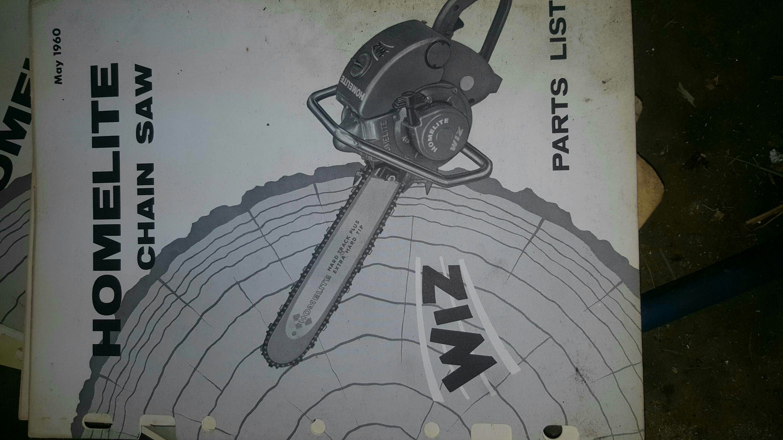

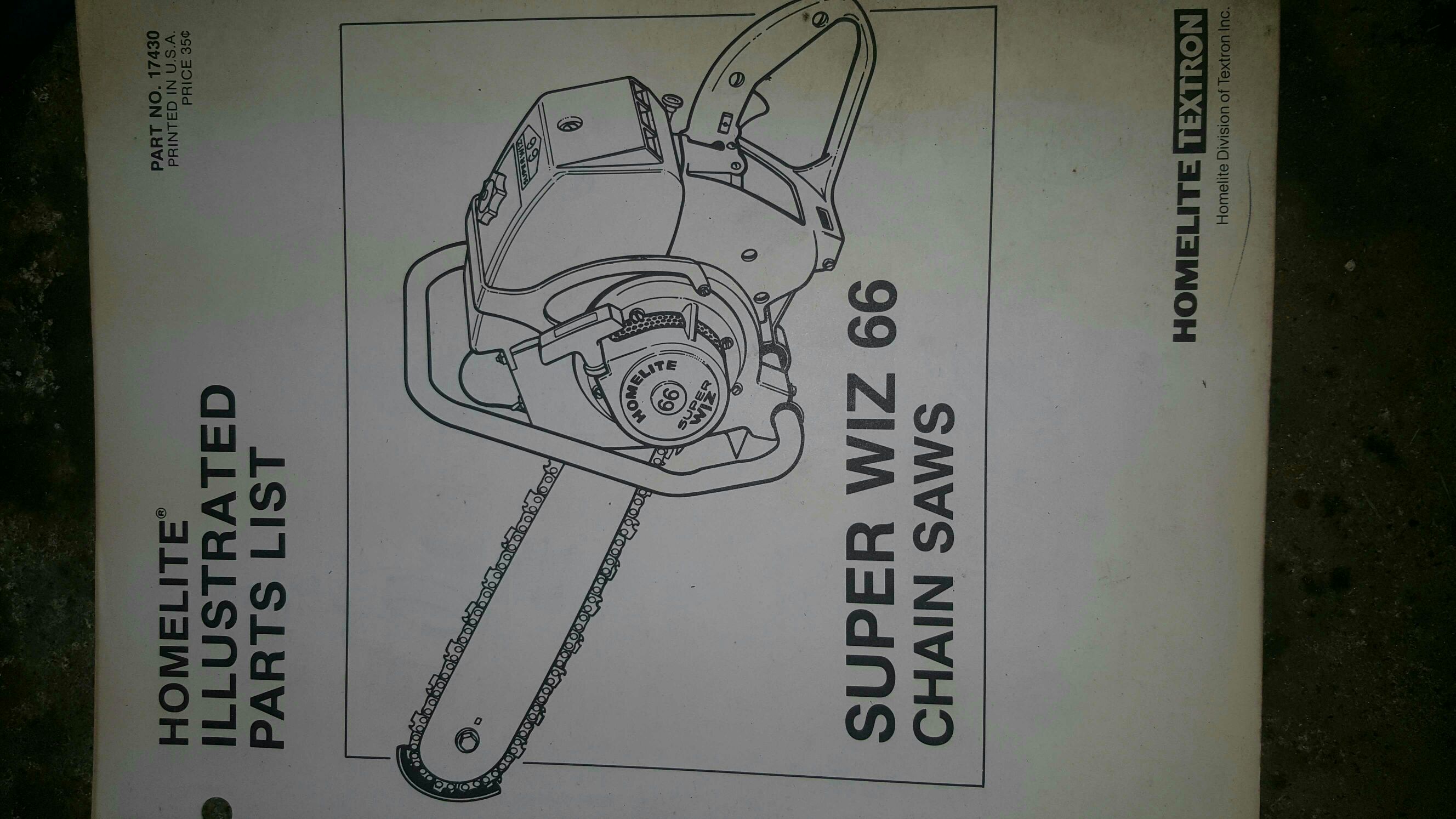

Missed the missing tag part.I have the IPL here for the wiz saws I could post a couple pics if that helps.
