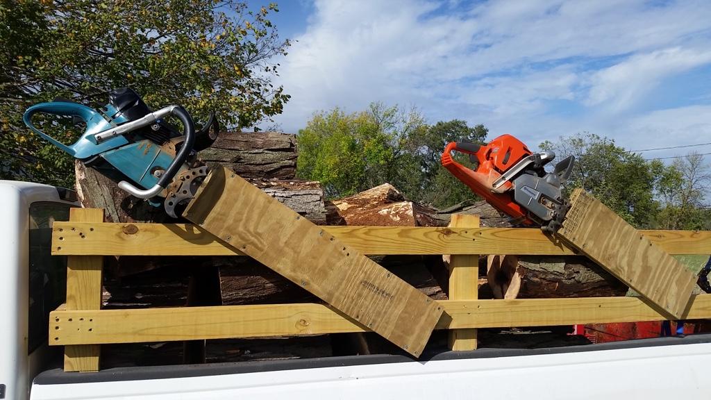

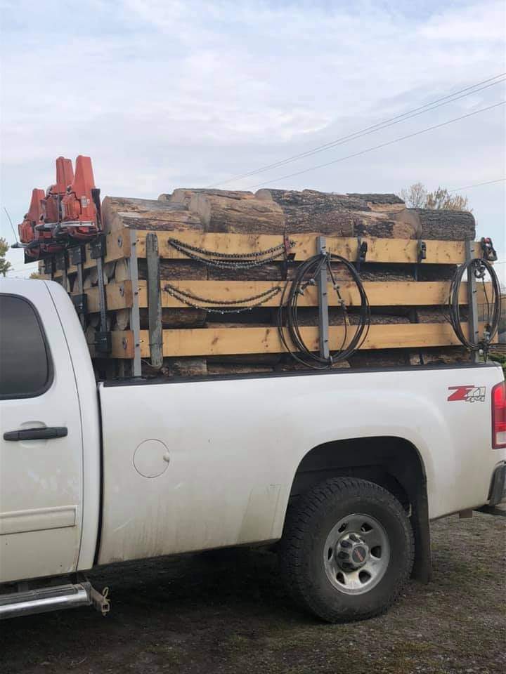

I have the same issue with a Kubota utv. On amazon they sell a composite thing that your bar slides down in (basically an oversized bar scabbard) that you can either bolt or zip tie to the mesh of the headache rack. Buttt they are super expensive for the casual wood cutter. Easiest and cheapest way is to make them out of 2x4's and something thin like decking boards. Then you can take U bolts that fit the width of the wooden box and bolt them straight to the rack. Whenever I get around to making mine, I'm going to use some sort of 1/4 or 3/8 hard plastic to line the inside of the bar box so that the chain doesn't catch or tear up the box.
Also get a big thick bungee cord like they use on big truck tarps, screw one side to the back of the box and put some sort of loop on the other so you can bungee your saws down for those extra rough rides
Edit: The pictures above this post are exactly what I'm talkin about
