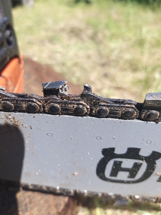

Keeping on cutting like this moron I sold a saw to. The bar was new prior to him. He says he only had 4 tanks of gas through it. He says he hit something in the log right away but it still seemed to cut so he just kept going. Fried it bad.
Poor poor saw85018094-29AC-4886-8128-61BFC171422B.pngDEE2FDE9-F6CD-41A8-B17F-6BE496CB7BD7.png
