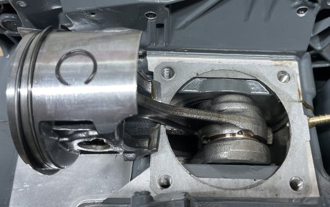

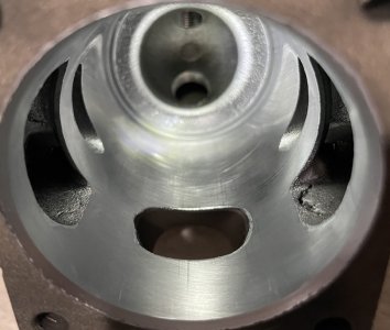

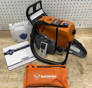

Received a new G660 powerhead yesterday to use with a 36" Alaskan mill I'm setting up. Started right up, great throttle response. Ran perfect through several stop/start cycles, no leaks, all good. Serial number shows it was built November 2022.
Checked timing in stock form, got these numbers:
- Exhaust: 95
- Transfer: 117
- Intake: 82
Plan is to install a Cross cylinder kit and OEM piston bearing, should arrive next week. Some pictures of the as built saw, overall looks pretty good. NGK plug, all fasteners were tight with blue Loctite

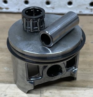

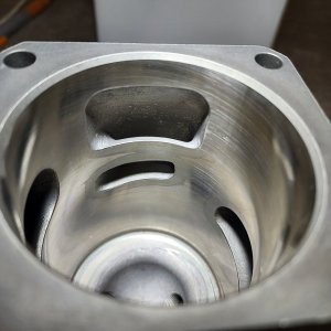

Crankcase washout with mineral spirits showed no sign of metal.

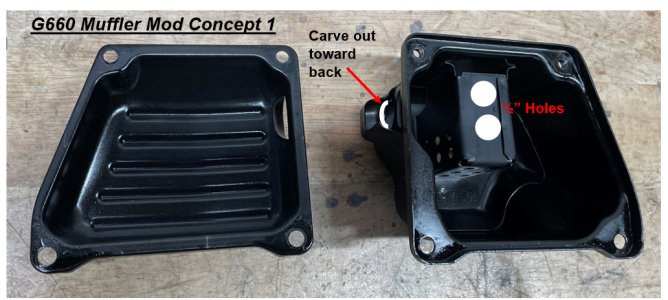

List of items for this build and running as an Alaskan mill / 36" bar:

- Muffler mod per below:

I’d run 25-28:1 with any oil, including XD. It’s cheap insurance. Milling is very hard on an engine. It’s max load/max output for the entire process, very different than bucking big logs.
I’d remove that entire inner muffler baffle and add another deflector to the flywheel side of the can. You‘ll want the exhaust to go up and away from you while milling. It’s a lot of work, and exhaust blowing in your face can make it even more annoying.

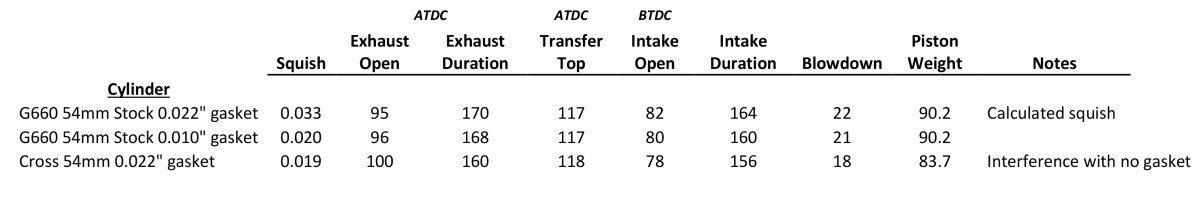

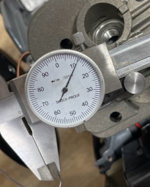

Measured 0.011” squish with the as built P/C without base gasket.
Timing numbers in first post were with as built 0.022” gasket.
With a 0.010” base gasket, squish should be 0.020” and reveal some decent timing numbers?

0.010" is about 0.75deg on opening numbers, 1.5deg on durations.

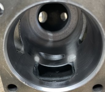

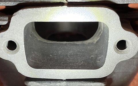

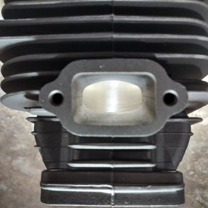

Received the Cross P/C kit today, not sure I like what I see. Needs additional work before I would build a saw with it.
Installation with no base gasket showed interference, contrary to what others have reported with this kit. Squish measured 0.019" with a 0.022" gasket, here's how timing numbers compare to the Holzfforma as built P/C:

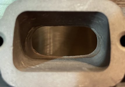

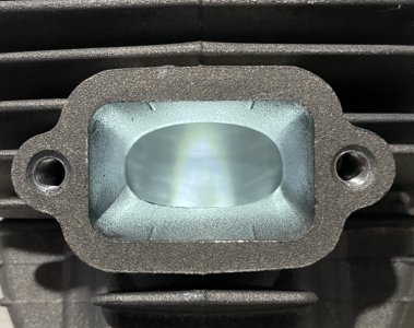

For sure the exhaust needs beveling and clean up, it is very flat on both top and bottom, with jagged edges
The floor looks like it was patched with gray epoxy
Piston looks good, weighs less than the Holzfforma piston

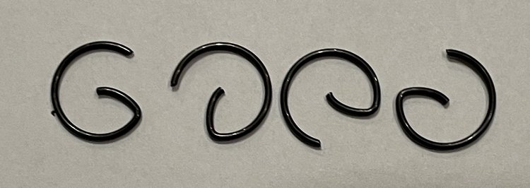

Not sure if I would use the piston pin circlips this came with, they included 4
Next step willl be to put the saw back together with the Holzfforma P/C using a 0.010" gasket and a Stihl piston bearing.

I’d run the cross. I always run a gasket if I can.
smokey7
2:59 AM
761
Feb 3, 2016
1,537
3,553
Detroit
I like everything about the cross kit except the exhaust port. Good numbers light piston. I must say i am impressed with your farmertec cylinder. That sob sure looked better than any of the ones i have seen.

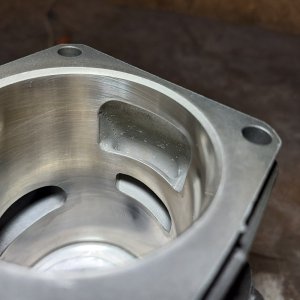

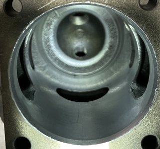

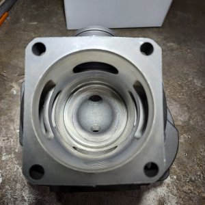

I thought it looked pretty good as well, and timing with the 0.010" base gasket looks OK.

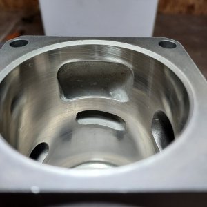

Maybe I'll do some mild work on the Holzfforma cylinder it was made with to widen the ports a bit?
Some more pictures. For sure the exhaust port shape on the Holzfforma cylinder looks a lot better than the Cross jug.

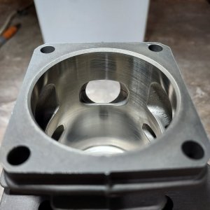

Hey paul. Here's some pics of the duke's reserve top end I mentioned. Greg @farminkarman recently did a build with one and maybe he can chime in and give his input of what he thought. I thought the transfers were pretty nice for aftermarket as well as the rest of the ports. Here's the numbers I came up with using an oem base gasket...95/122/80 with .022 squish
