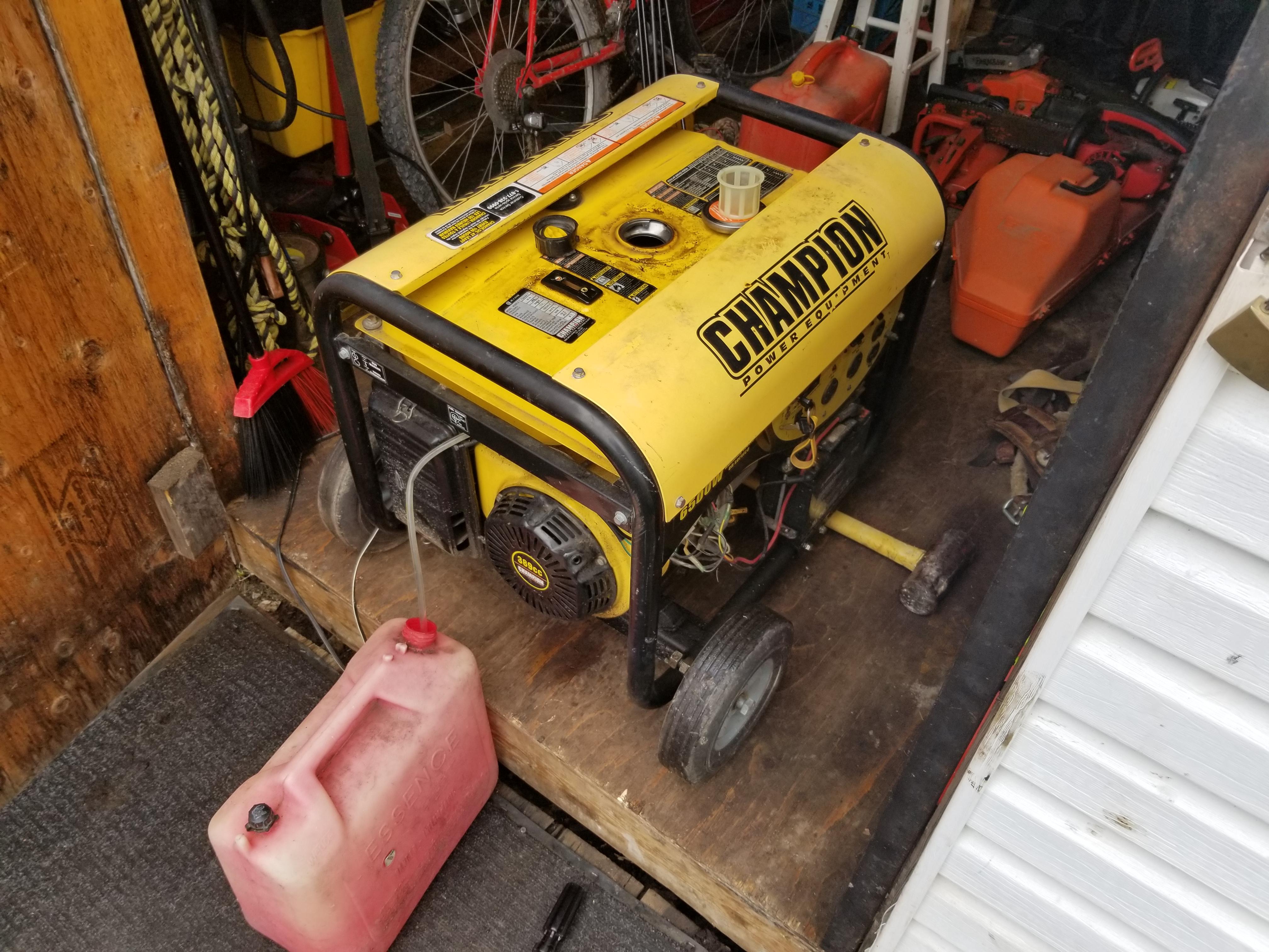

I've got a bad habit of leaving generators out in the parking lot for extended periods of time. Here lately I've started covering them with a piece of plastic or a tarp just so they dont get sun bleached. I mean in the long run, like 2 or three years at a time, the frames will rust and the generator block will start to corrode, but it really isn't too awful on them to stay out for a few months at a time. Ive got an old champion gas generator thats been outside with the same fuel sitting in it, uncovered for 5+ years. Cranked on it the other day and it fired up 3rd pull. I was absolutely shocked. Oil looked good, ran fine, gas looked and smelled like sheet. And the tank and plastics are pretty discolored. But it still runs. Generators are alot tougher than people give them credit for. They will be fine outside as long as rats don't build nests in them and water doesn't get in them. You always run the risk of the actual generator part getting messed up by moisture but unless your sticking it in a controlled environment like your house, it's still going to be subject to moisture damage. Like previously stated, keep an eye on fuel lines, filters, and the carb getting junked up, other than that, give em hell
