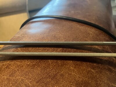

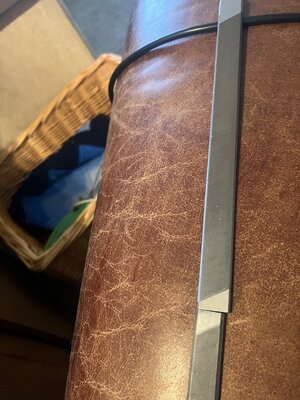

I've got two left that are unlabeled. They're both slightly thicker than the pferds and quite a bit wider.

foresterntree
8:44 PM
15647
Feb 6, 2021
25
47
California
Are those larger ones Pferd as well? I've observed the same from Vallorbe, their double bevels are half the width of the old models (I've got some of their double bevels, chisel, and three-square/triangle that I sell, too). The direction all the square file manufacturers are moving seems to be narrower files - probably less steel they need to pay for in the long run...

Norcal
I believe the wider ones are Woody's. There's no mark on them. The narrower ones have the Pferd logo.

California
Yep, it looks like those have the uneven side bevel widths that I was referring to earlier. The top bevel seems a little wider than the bottom - characteristic of the ones I've got as well...

Norcal
. Never occurred to me they could be different dimensions. When I switched files to touch up a chain it did take a lot more work than it should have.
