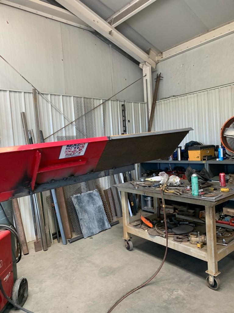

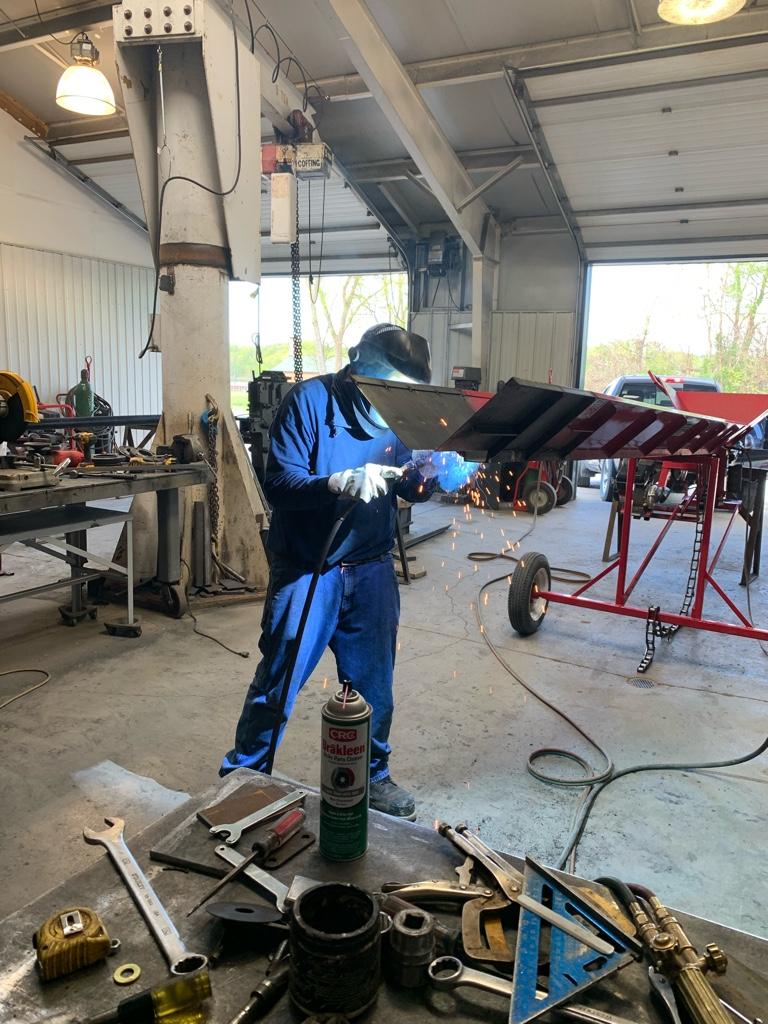

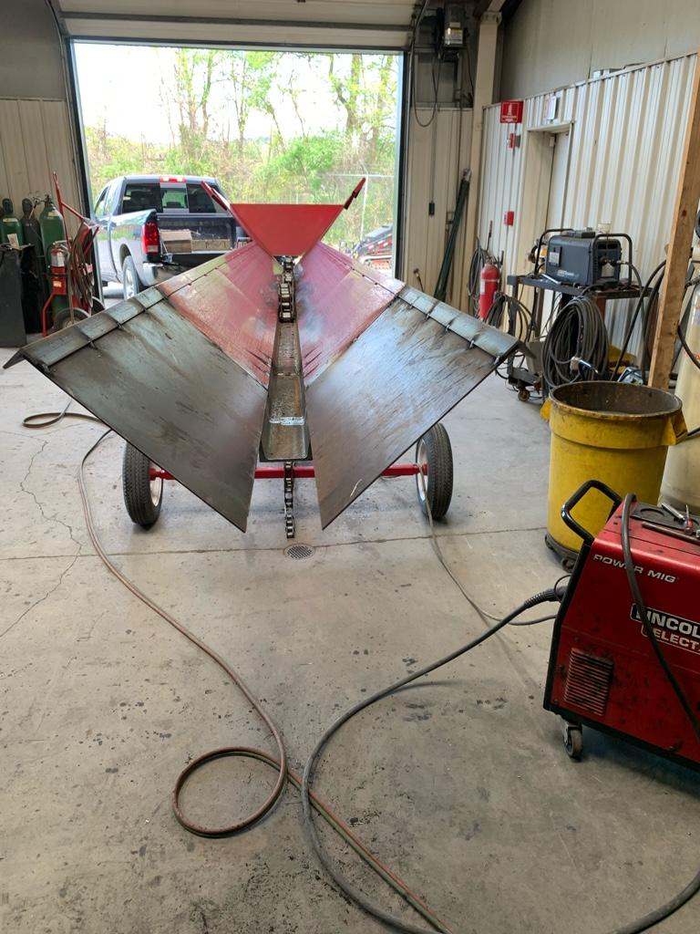

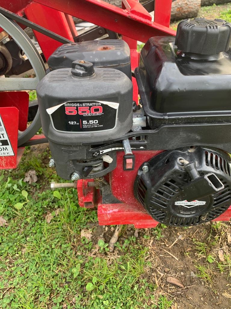

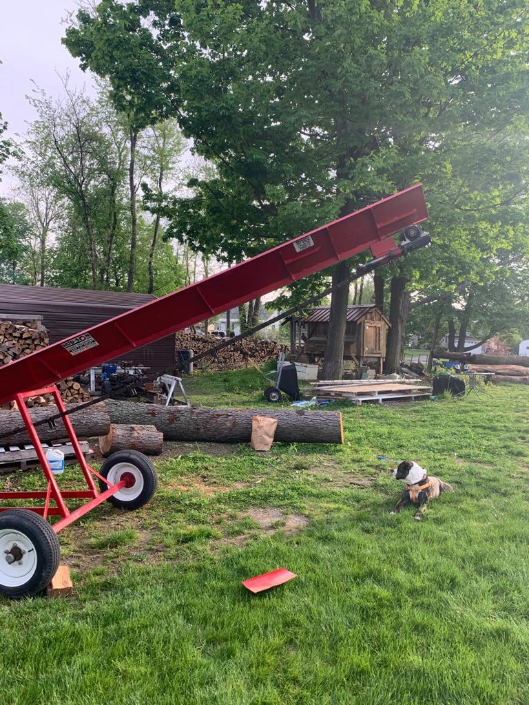

Father bought us a HUD-Son 12C I made a few modifications. One I made it 2 feet longer to reach higher and center of the 2 dump trailers. Then made a rubber guard to stop small splits from falling back and jamming. Much better after that. Splits still get suspended at times in the trough and need a split thrown at them so the chain grabs the splits. (I'm not the welder lol)
