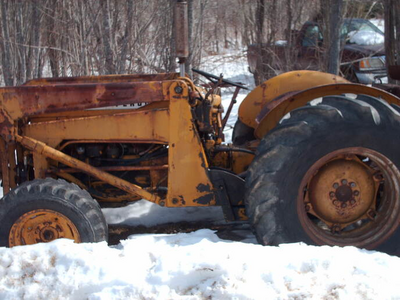

Now I have turned wrenchs on old rusty machinery since I was15 years when I rebuild my first tractor engine,a1938 Allis Chalmers model B . Then along comes one that is giving me fits .1950 Ferguson TO 20 .Not a big deal except this old antiquie has a Davis /Midwest hydraultic lift .As such you can't see anything ,the flippen lift assembley is in your way .It makes mountains out of mole hills .
What happened was the ignition parts ,points needed replaced and with the lift in the way I had to remove the distributor and trying to find top dead center on number one cylinder I just couldn't get it right . Ended up removing the gas tank to remove the valve cover so I could watch the valves .That's where I stopped out of frustration .Best to cool my jets for a day or two over this damned thing before I take a ten pound sledge hammer to it .So it goes in the life of a shade tree mechanic .--humbug ---

I might add these were good old loaders .They'll lift over a ton .How ever with no power steering it's a job to get them to turn with a load on .I had to double plate the center front axle because it spread the tires from being bent from over loading it for years by the previous owner who I worked for as a teenager .It's got barrel of concrete for a counter weight plus cast iron wheel weights other wise it will tilt the rear wheels off the ground .Heap big loader too small of a tractor .

I won but it was a battle .I had to get creative because of all the obstructions .I had no way to roll it over by hand so I used the starter .A six volt starter running on 12 volts really scoots so it took several tries to get number 1 cylinder up in nearly the right place . Started right up slick as snot on a door knob .Once running I'm pretty good at just using my ears .
