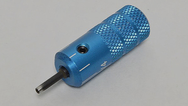

Every place on line is out of stock. It's a mini-D mixture needle adjuster. I need this tool to set the mixture on an ECHO Blower PB-9010T.
The long version 91159L is too long to clear the air cleaner. If anyone has an extra one, I'd be very interested in purchasing it from you.

Is it possible to shorten a long one then replace the long one?
Hi Ray. Yes I'll cut the long one down if necessary. I've got two of the short ones on order from two different places, but they may take a long time to get off back order. Right now I'm wondering how accurate of a mixture setting I can get with the air cleaner off; probably not very accurate. If I get it all dialed in with the air cleaner off, the mixture will probably go richer with the air cleaner placed back on because of the restriction in airflow. I should probably just be patient and wait until the short version shows up.
