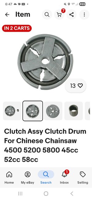

Sorry i dont have a picture from my saw but they all use the same clutch. There's a Pic I found that is the same thank you
