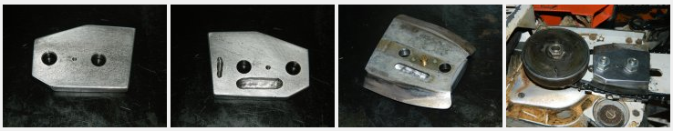

I was having a similar (but opposite) issue milling with a milling chain...dust instead of noodles. I made a bar clamp out of 3/8 plate:
Works like a charm, but I have been thinking about fabricating a plate to keep dust off of the muffler.
