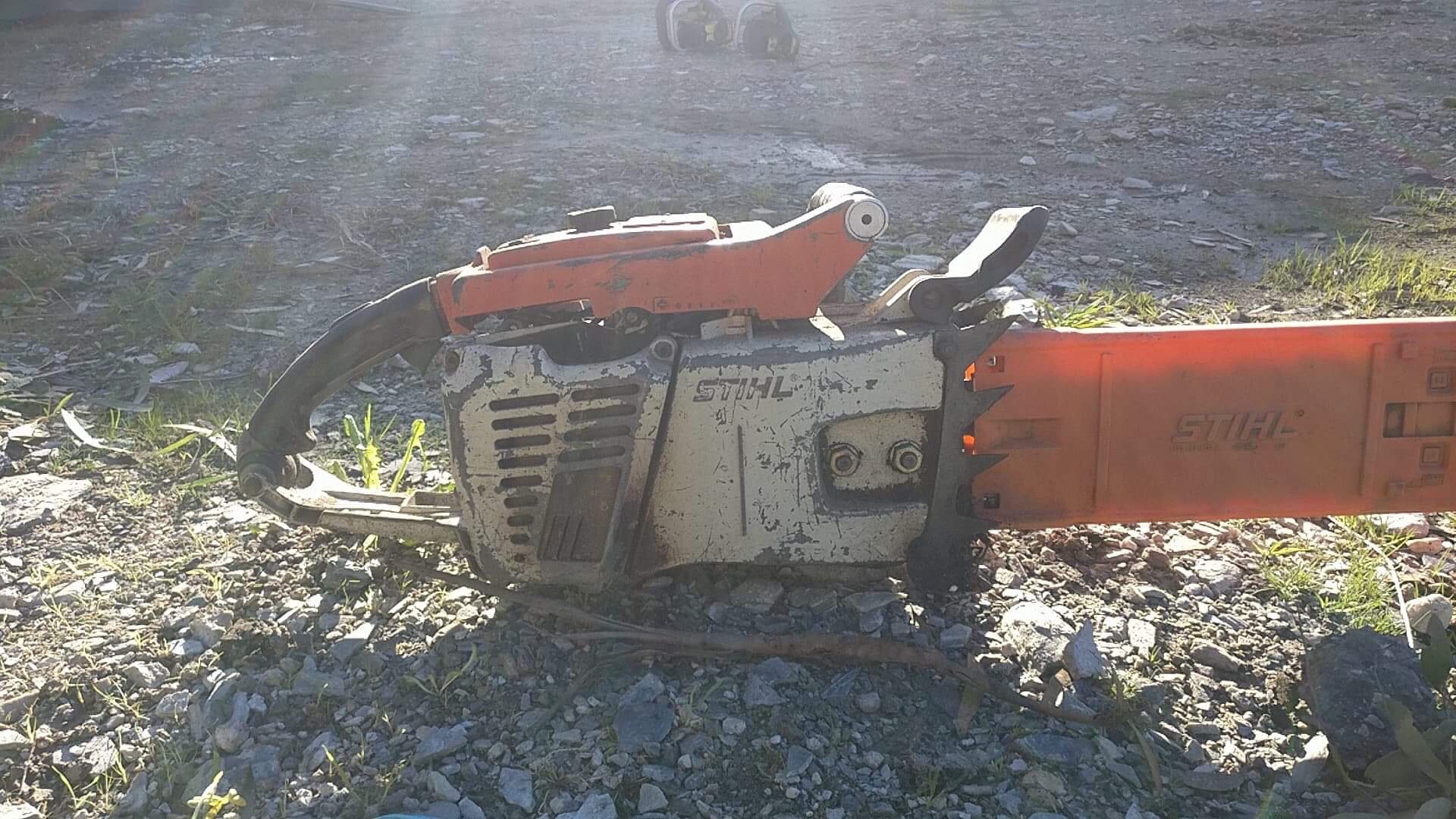

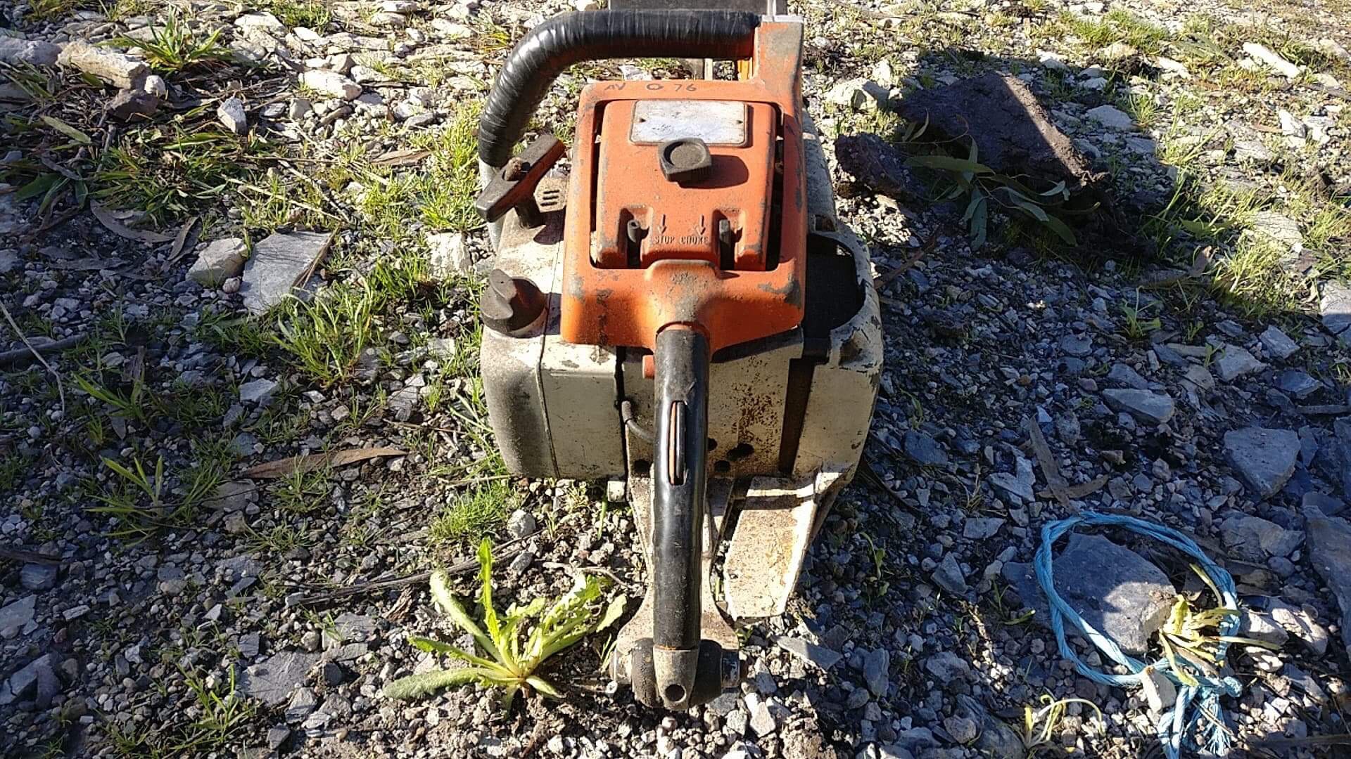

Can anyone tell me what I’ve got here

old 040

More than likely an 051av, no manual oiler, so it's not an 075/076.
Lee H
9:27 AM
573
2,675
14,392
cape cod ma.

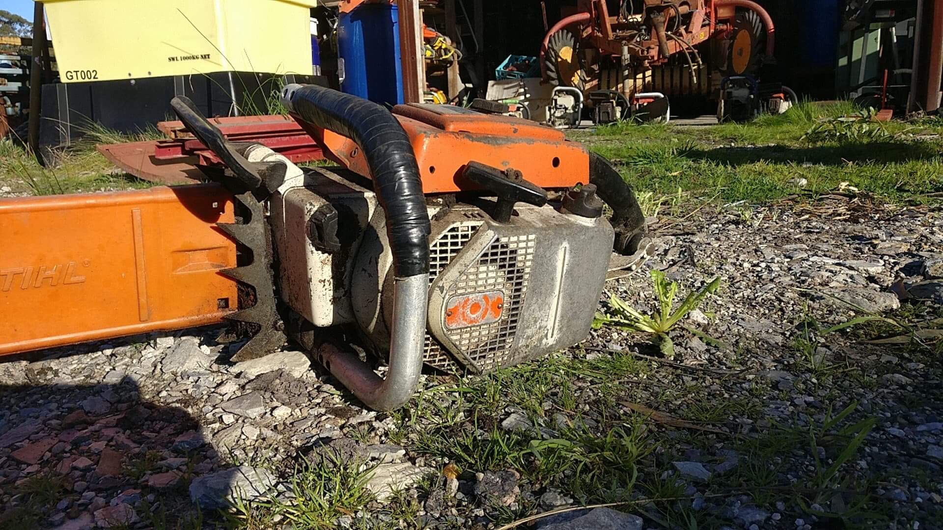

Look to see if you have bolts or long studs and nuts holding the cylinder to the block.
Bolts = 051, studs = 075 or 076. If you have the studs and you have the side oil fill
along with the 075 style recoil then you will have a very late 075.
