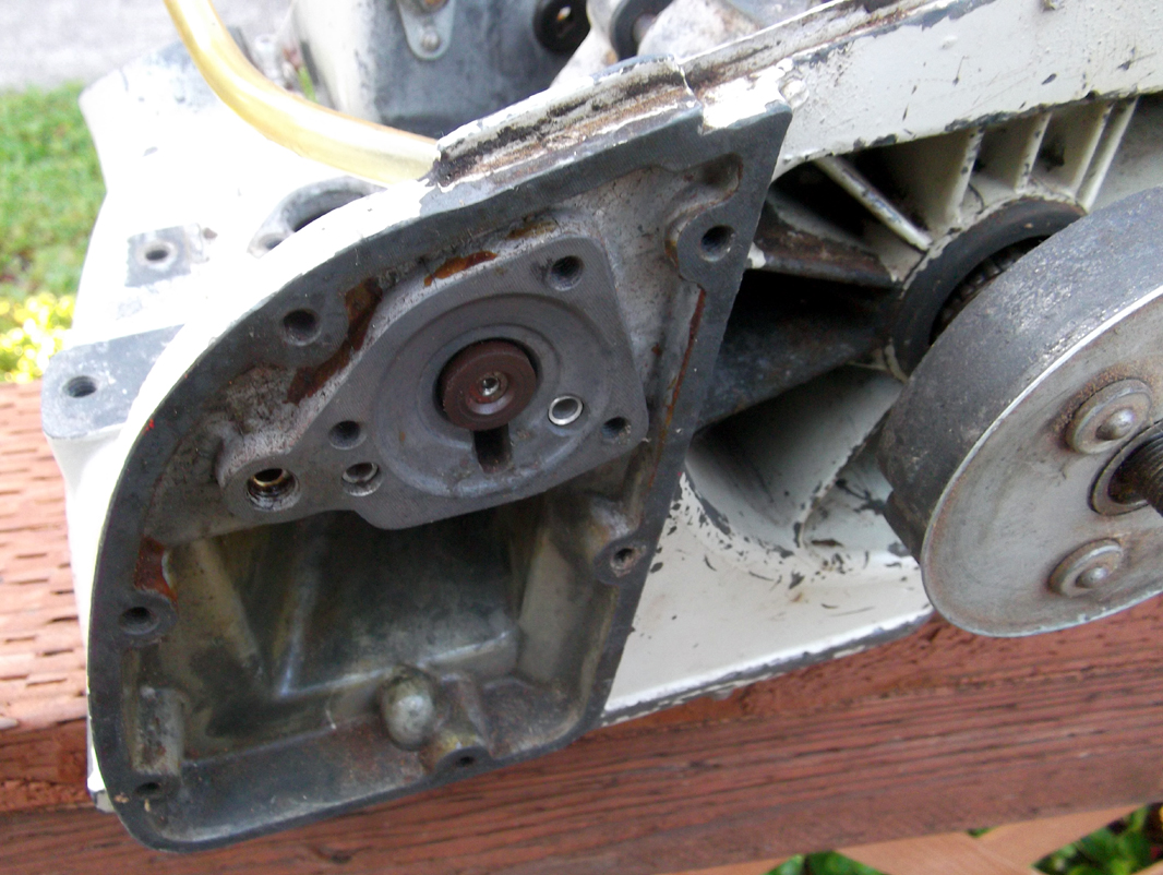

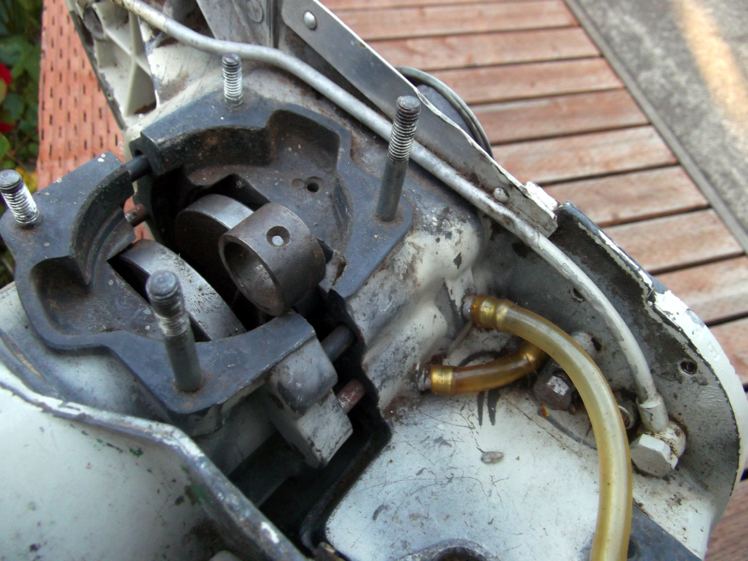

The only connection between the oil tank and the crankcase on a Contra is the pulse hose. The pulse hose delivers impulse from the engine
behind the oil pump diaphragm. So if you have bar oil getting into the crankcase, then you likely need to replace the oil pump diaphragm.

Jacob - much appreciated. I found a service manual too and probably missed where it mentions how it gets impulse. Those photos help a lot.

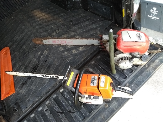

These are my 2 "beasts!". 064 beside Contra/Lightning.
