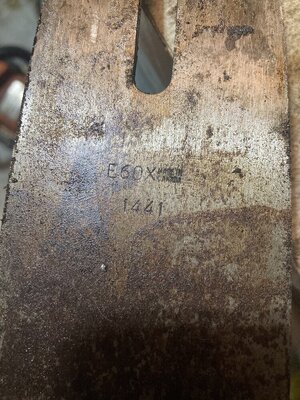

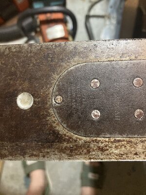

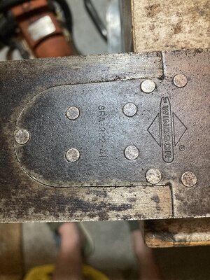

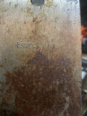

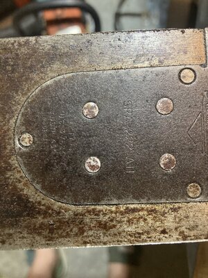

I’m hoping for some help identifying the brand and DL I need for this bar. The tip is a Windsor so I expect the bar to be Windsor. It was on a 930 Jonsered. A5852FB0-2CFD-4A4B-B49F-BF49EB9ABA38.jpeg2DD23D98-2B3E-4B03-B20A-7489B4856B49.jpeg306081D4-5CDE-4B71-B27C-B97D416B8E75.jpeg67191E22-3884-4A15-87A5-3BDE700B725D.jpeg82C024F5-204C-4C93-9F2E-3F24EA9077D6.jpeg

Looks like 3/8 .50" should be 84 drivers

That’s my assumption as well. But I can’t really find a cross reference on the older Windsors bars. So I’m hoping some experienced people know more than me.
I have some 3/8 0.050 chain so the length isn’t as important as knowing what the actual length of the chain should be.
I too would assume 84dl but it could be different. I really don’t know.

My old 930 took around 4 extra drivers iirc. Standard 20 inch bar that's usually 72 was more like 76 but it has been a while.
