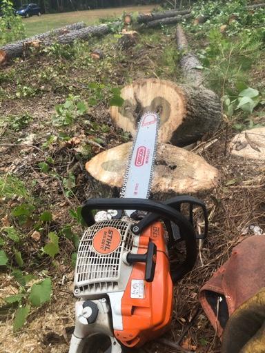

One of the resident knowledgeable people around here sent me a 20” cannon with the correct chains to try: it was nice, but for everyday working I went back to .325” sharpened with a 13/64” or 7/32” file.
I use my MS261CM for lots of stuff & noticed the Picco likes to jump off when felling.
I find the big file sharpened .325” seems to do a bit better than regular .325” in that it loads the saw a bit more & seems to be a tic more wearable.
MOFO MS261CM with 81dl/20” .325” big file
