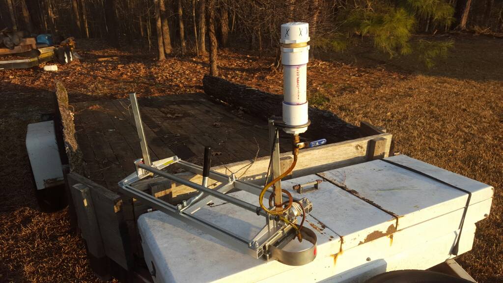

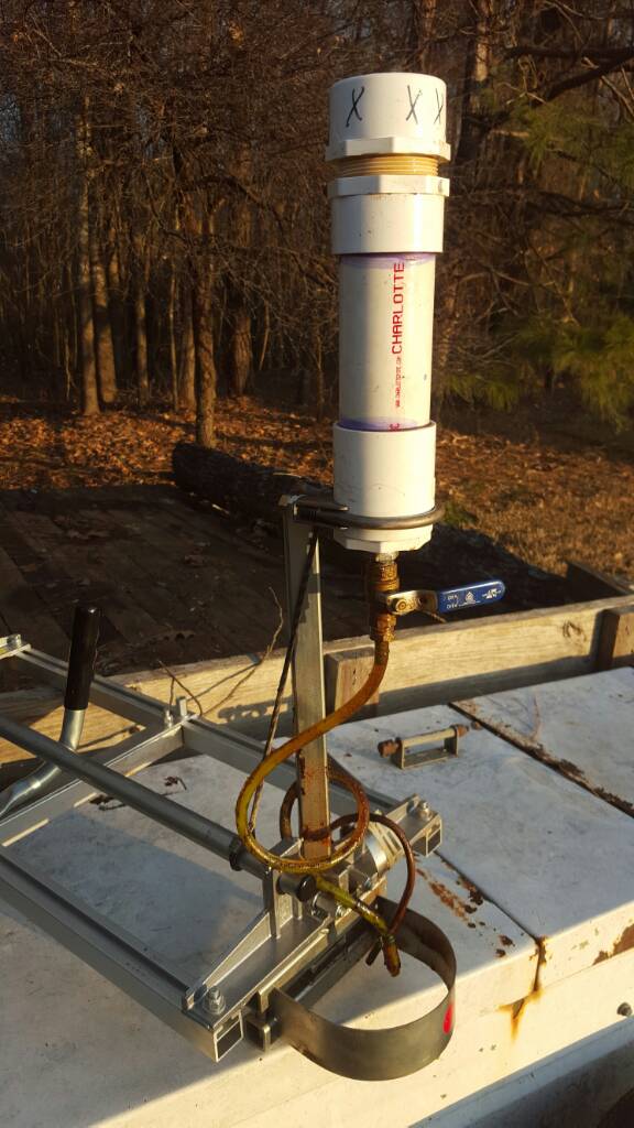

Whole thing is clamped with a muffler clamp that has a long 1/2" bolt that hangs down in the upright. Slides off real easy. Small 1/16" hole in one cap for vented, one un-drilled for storage.

I copied the oiler that Jimmy made (saw it a while ago on AS) and its great! Thanks for sharing the idea.
The one thing I might add at the end of the hose is a bolt with a hole drilled in it. Just makes it a little more precise so the oil is going exactly where you want it.
I've done that too...the 1/4" ball valve will flow the oil.
