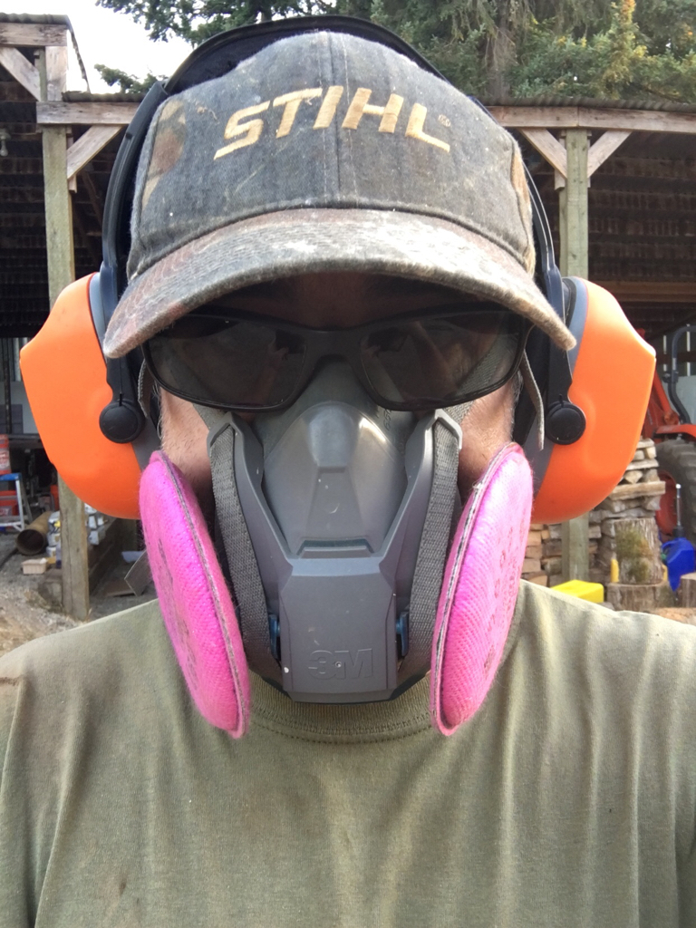

Sure do. 3M with p100 filters. Sometimes I’ll use spent organic charcoal filters I’ve used for staining and finishing in the woodshop. Helps with dust and fumes. I’ve been thinking of getting a PAPR full hood with HEPA filters.

Today is hot but breezy. I should get that mask in his pic, nice one, and chop the beard when serious milling in splated wood and others that can be a hazzard when dry dust flys around you.

I run 3Ms 2297 filter, which they call an "Advanced Particulate Filter", still a P100 though, I do feel the 2297 offer the better blocking when compared to the standard P100 pink unless you go full face or run a PAPR like cease232 suggested...which I am contemplating as I have my miller HEPA PAPR for my other day job of melting metals together.
