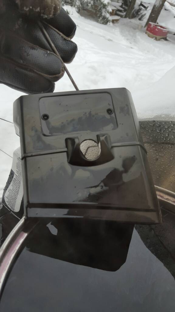

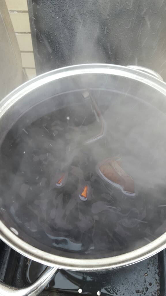

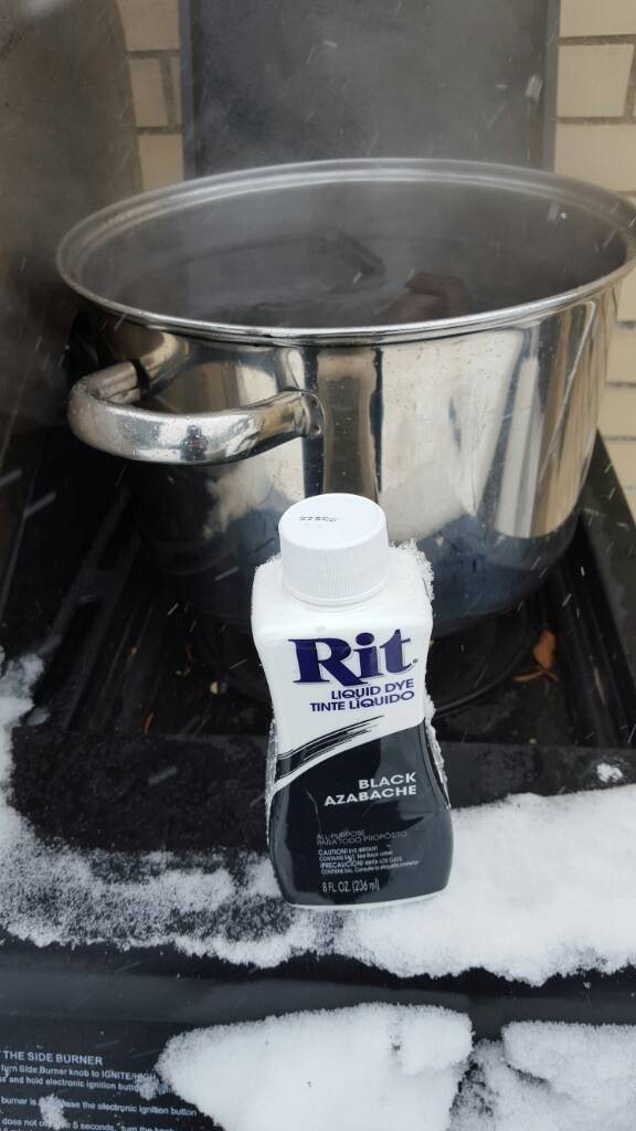

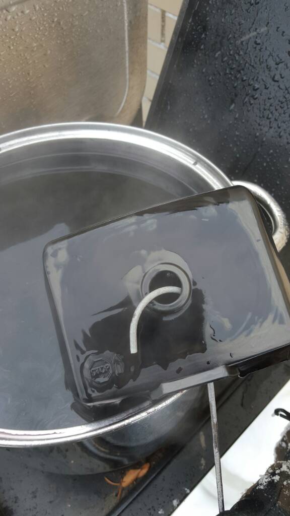

OK I worked 3-11 last night and I have a 3/1 double today. So last night I came home and degreased the parts and got everything ready for today. Woke up to almost 9 inches of snow this morning according to my daughters snow ruler!
I got my water started on the stove while I dug a path to the grill and got it fired up. Moved the pot to the grill and added the dye.
Gave it a good stir and added the parts! After only a short while they were starting to transform!
I left it alone while I went on snow removal and stirred about every 15 minutes. After about an hour they look like this!
In letting them go a while longer just make sure I have a deep black color and because this is my first try at dying parts! More to come!

That's cool. I wonder how deep the dye penetrates into the plastics? All the way or just the surface few thou? Thinking of future scratches here, wondering if they would show black or weather they would show orange
