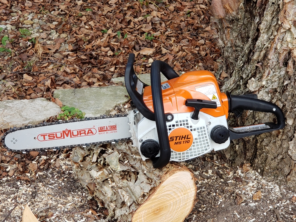

I believe the "stock" set up is 3/8 picco aka low profile with. 043 Guage. This chain is puny. Upgrade to .050 Guage requires new chain and bar. You do NOT need to change the sprocket drum bc pitch is still 3/8 low profile. 14" bar is good setup. Will be 50 dl.
I run this on MS 170. Works great.

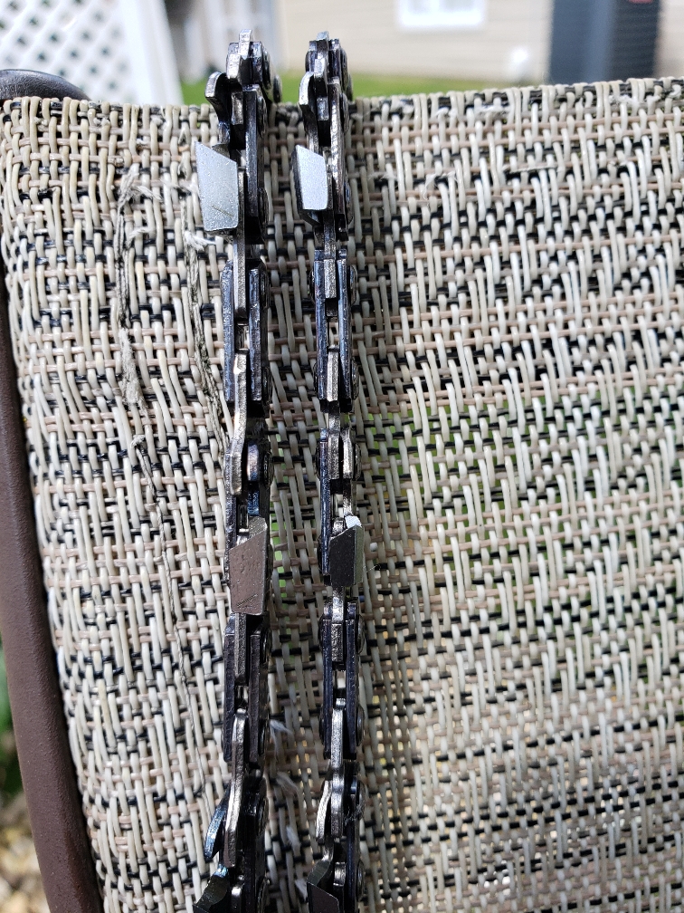

See the comparison between..043 ga. and .50 ga. Chain, rivets, teeth are all better and longer between sharpening.

Wow. I can’t believe there is that much difference just from changing from .043 to .050.
AVB
5:42 AM
1240
May 4, 2016
676
707
Elora, TN
Yes .007" is a lot difference. Even when you change between .058" and .063" there can problems and that is only .005"
