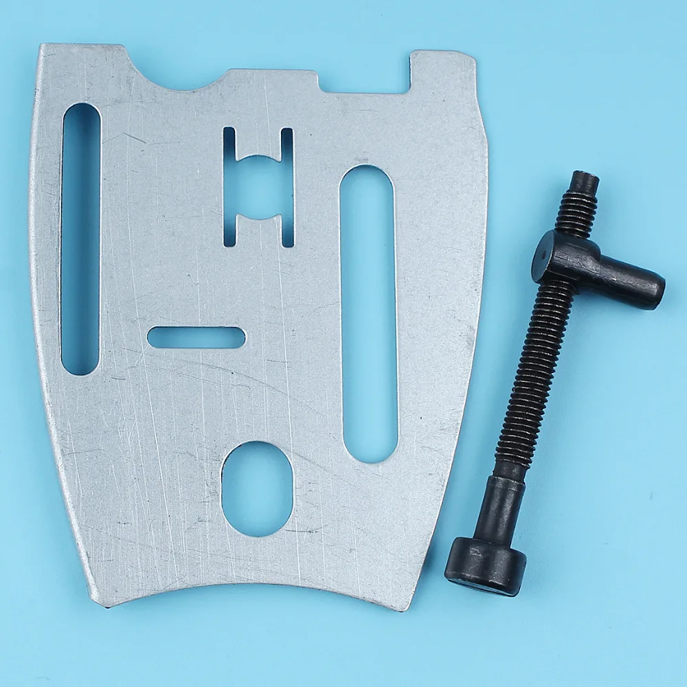

It looks like it's missing the bar plate:
Also, your's is a later model 281xp as well The earlier ones were silver plate serial tags marked 'Electrolux'.
