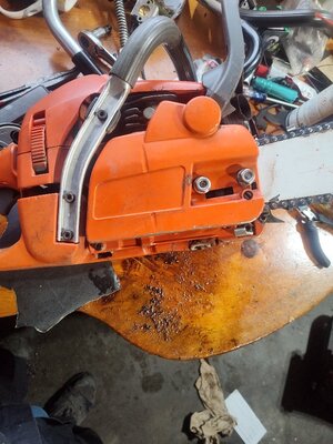

S Shane¹ Pinnacle OPE Member Local time 12:22 AM User ID 15023 Joined Dec 21, 2020 Messages 1,407 Reaction score 3,889 Location Kentucky Yesterday at 2:13 PM #7 Put one of these on my 346 seems to work just fine. Tensioner was a little crunchy the first couple turns but other than that seems fine 455 clutch cover Amazon
