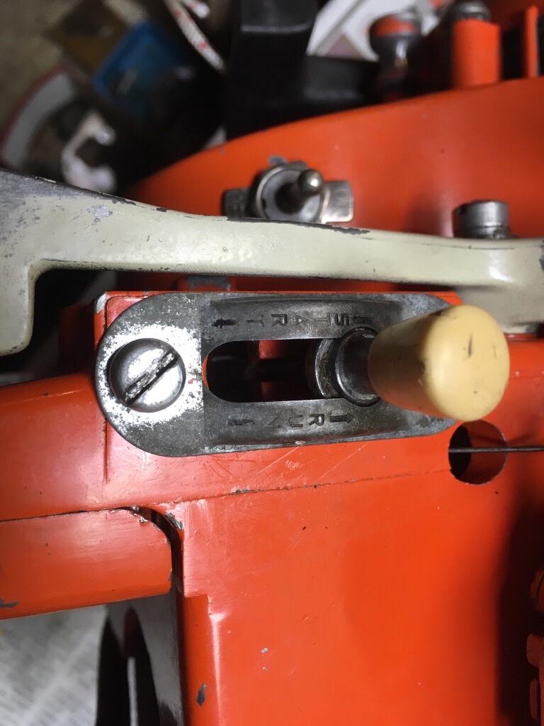

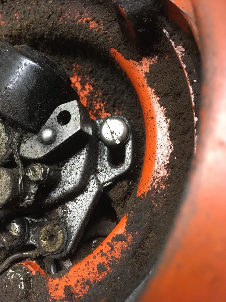

Wright C-70 saw has the magneto mounted on a pivot that has a link to a lever on the rear handle.
It adjusts timing about 20 degrees.
It’s actually to control kickback at startup.
One wants to avoid 114cc from ripping the starter handle out of ones hand. [emoji31]
