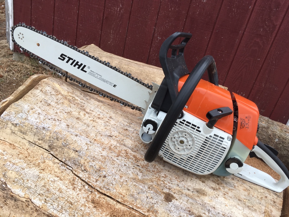

Looked like it would be a MS440 or 038.

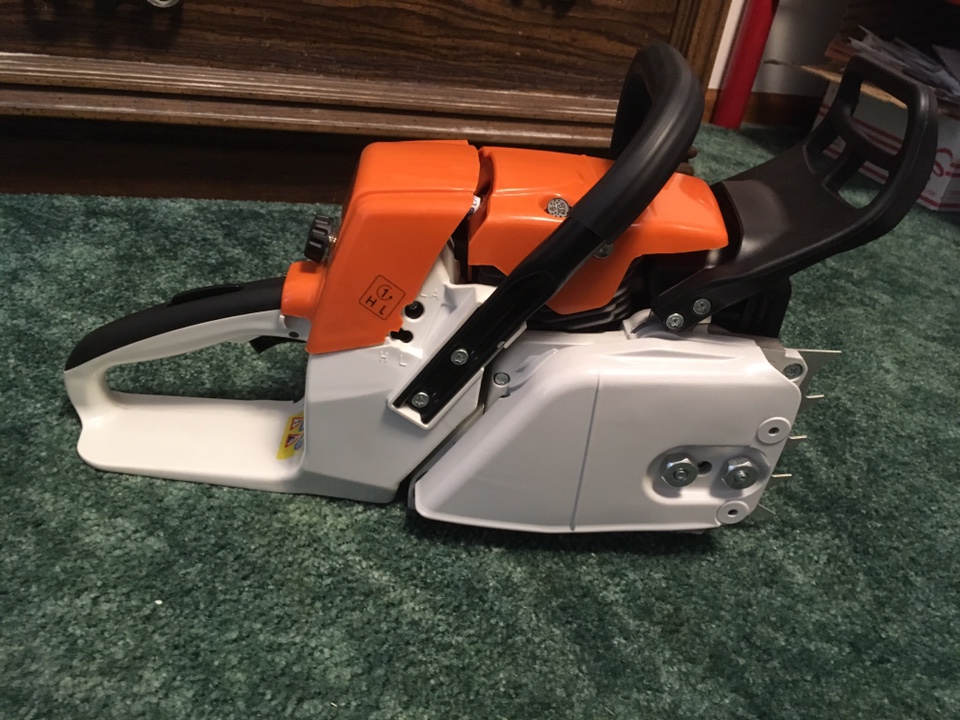

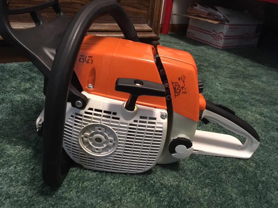

Ta Dah! An 038 copy.
Nice touch huh?
We gave it a very careful examination.

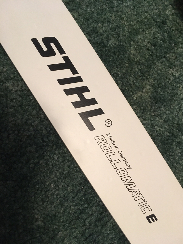

It had issues with the bar adjuster and the oil cap from the get go.
#5 was missing.

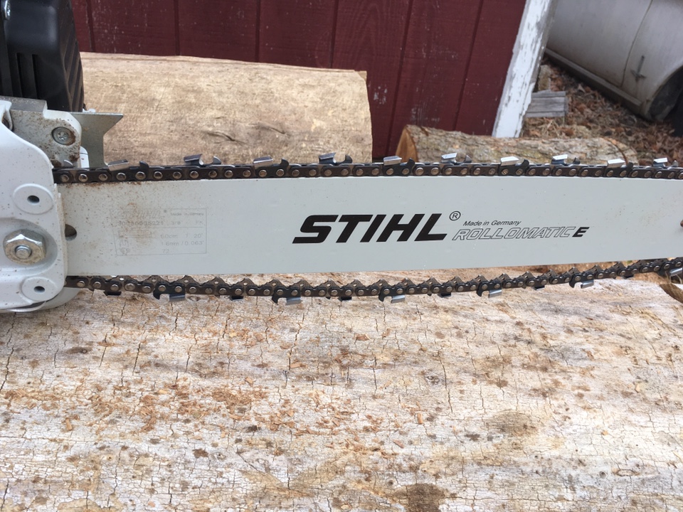

We got a 20” bar instead of the 18 mentioned in the listing.
Looks legit but.

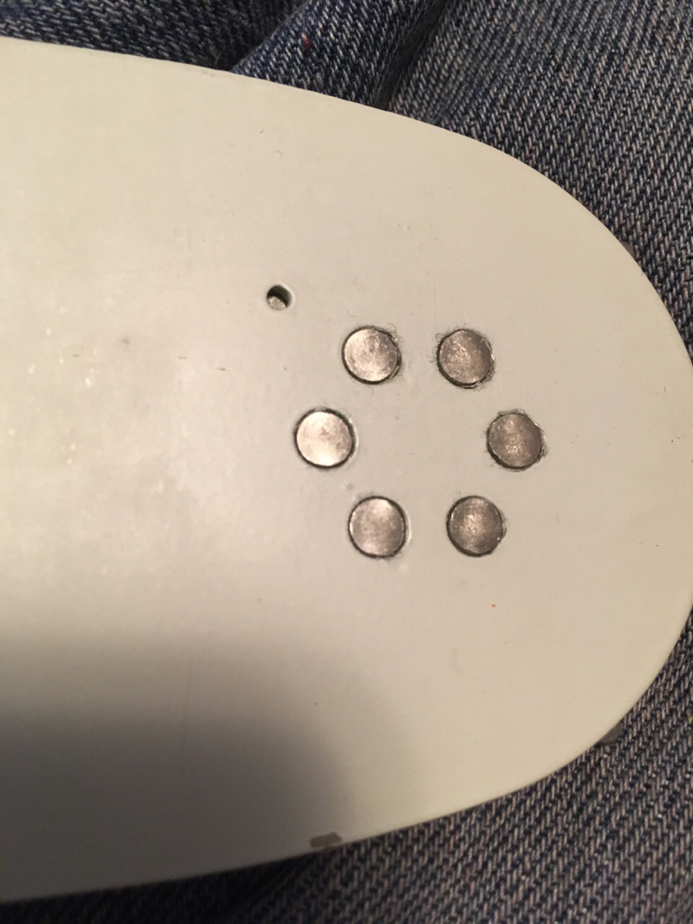

The arrogant Germans don’t put grease holes in their bar tips.

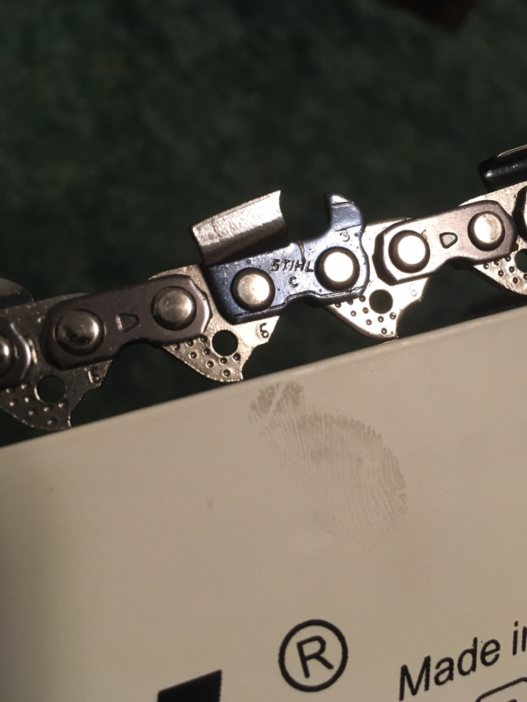

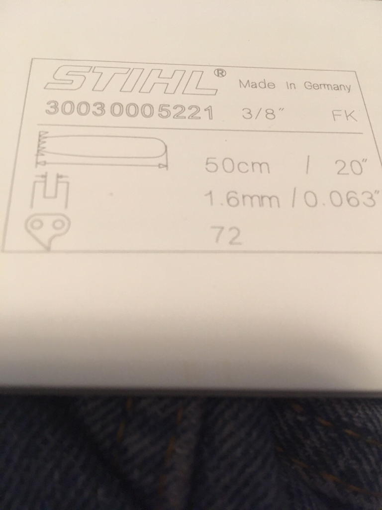

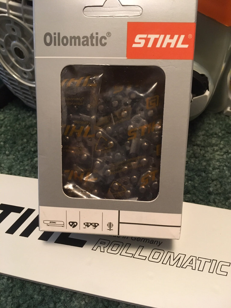

The “high quality chain” came in a fake box.
We looked over the chain cutter by cutter and link by link.
We found one cutter that had never touched a grinder and one looks exactly like a low profile cutter.[emoji849]
This morning we gave it a go. Started on the second dribble of fuel and ran, idled normal. We did not touch the carb.[emoji15]
Replaced the AF and cover and cut a couple big cookies.
Impressive. [emoji106] Needs a 24”.

The bucking spike (small) was mounted upside down. Weird.

Wow,,, they went almost all the way to copy that saw...love the rollamatic and the grease hole..:rolleyes:

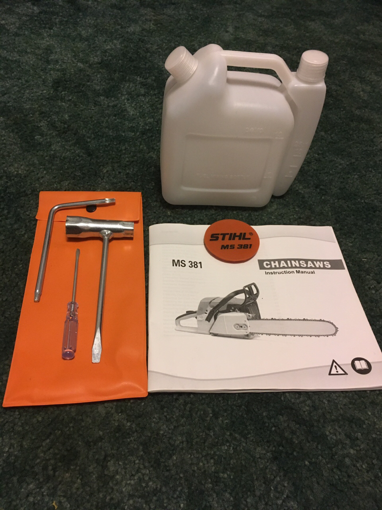

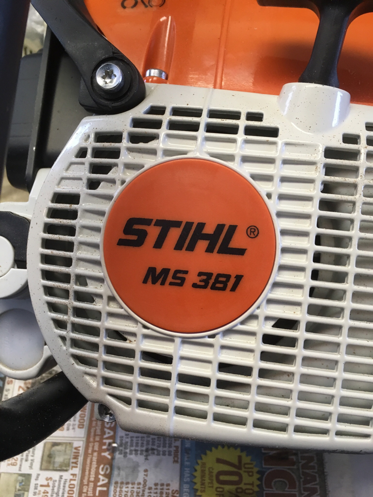

Also in the box:
Now we have a excuse to remove the starter. [emoji6]
I like how they copy everything to the nth degree – yet they force the end user to attach the items branded "Stihl" as if that gets them off the hook!
I'm anxious to see how it all works out. Doesn't look bad for 300 clams delivered!
Question: Does the carb have limiter caps? :goofy:

Also in the box:
How is that badge attached to the cover? Most times that stuff just snaps on, a bit of good adhesive ensures it stays in place. Think I will just keep my OEM 038 Magnum , not trade it in on one of these.
67L36Driver
6:39 AM
596
9,562
40,712
Four pegs melted over on the back side.
In your case, just get a Farmertec 380 kit and use it as originally intended, spare parts. [emoji108]
