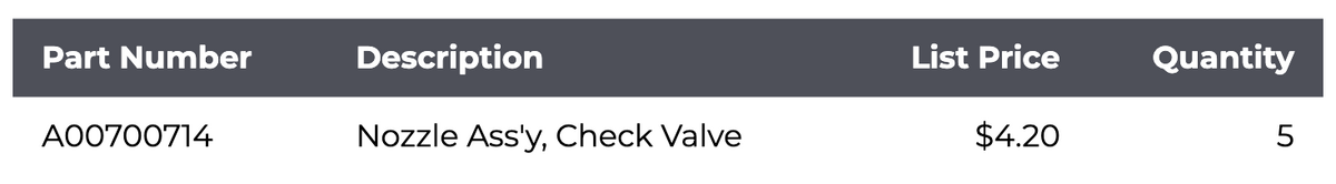

found a part number on Zama's website...
I don't see it available for purchase anywhere. I reached out to Zama to see if they could get in touch with a retailer that could special order it. No word back yet.

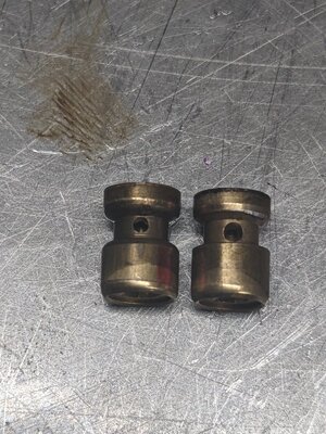

I had a spare 562 carb on the shelf. Punched the nozzle out of the 572 and 562. Both are 5x7mm. Atomizer looks the same, but the feed hole is larger on the 572 nozzle.
562 on left 572 on right

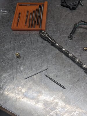

this is a dumb idea right?
chances I can get all the brass out and don't clog the atomizer? I held the nozzle upside down while reaming the hole out. I'm hoping most of the debris fell out. Tried flushing a bit with kroil then a few minutes in the sonic cleaner with the feed hole facing down. I figure it's worth a shot.
Assembled the carb and tested. Holds vac on the purge side no problem now. I'm hopeful this was the root of the problem
