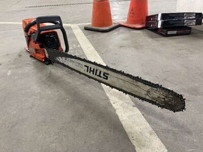

Then it was time to take the 395 with a 42” Stihl mount bar and my 372 out on a job.
Had not seen a photo anywhere of a 395 side by side vs a 372XP or other 70cc saw. Here’s your size comparison.

Okay, first job. Remove a freaking huge cottonwood stump:
Very happy with the saw. It pulls a 42” like it’s angry at the tree, and this thing puts out oil like the Exxon Valdez. I’ve run ported 066/661s and loved them… but this saw absolutely defines what torque is.
