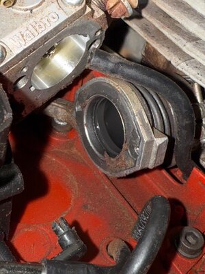

I found the shutoff wire loose and coil gap off. Reset the gap and left the shutoff wire disconnected from the coil in case there was an issue with it.
(Black coil)
Fired it up and at first it was fine, no change to how it idled when tipping the saw etc., and then it went bad again. It’s lean on L and fat on H and won’t hold a tune or respond to the tuning screws properly. Not acting like it’s limited, like an air leak or carb. I’m gonna try the 390 carb off my other 2175 tomorrow. Or my rwj off my 2166. RWJs can be finicky. Found some kits in my parts too.
Failing that, I guess I gotta break down and vac test

My air leak game (or lack of) needs work. What do you seal ports with?

Check to see if the crankshaft has perceptible sideways play. I just had one I was working on a week ago that had a worn-out PTO bearing pocket.
Seems healthy
Saw is almost new.
I blew it off first (desert wood is filthy dusty)
Not sure if it was sucking air there or I didn’t get it clean enough or…🤦🏻‍♂️
