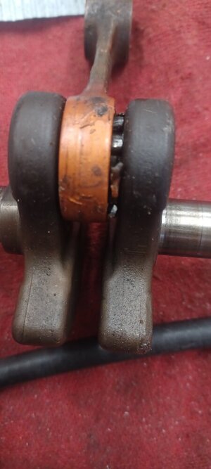

Is there a good quality aftermarket crankshaft for 372 xps etc out there that doesn't have the high prices like oem- build quite a few of these and my crankshaft shelf is empty of my oem ones and can't even find a source for good used ones, the saws I build generally go out for professional use and will get lots of hours so need something proven to stand up, there has to be a company out there some place that has high standards.- maybe
