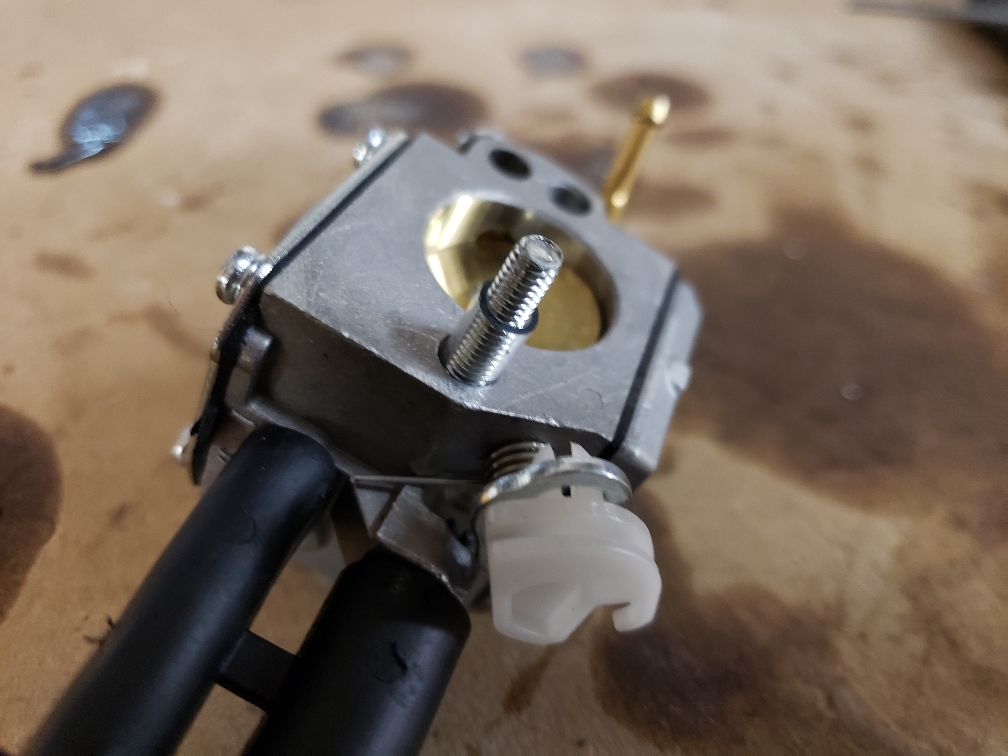

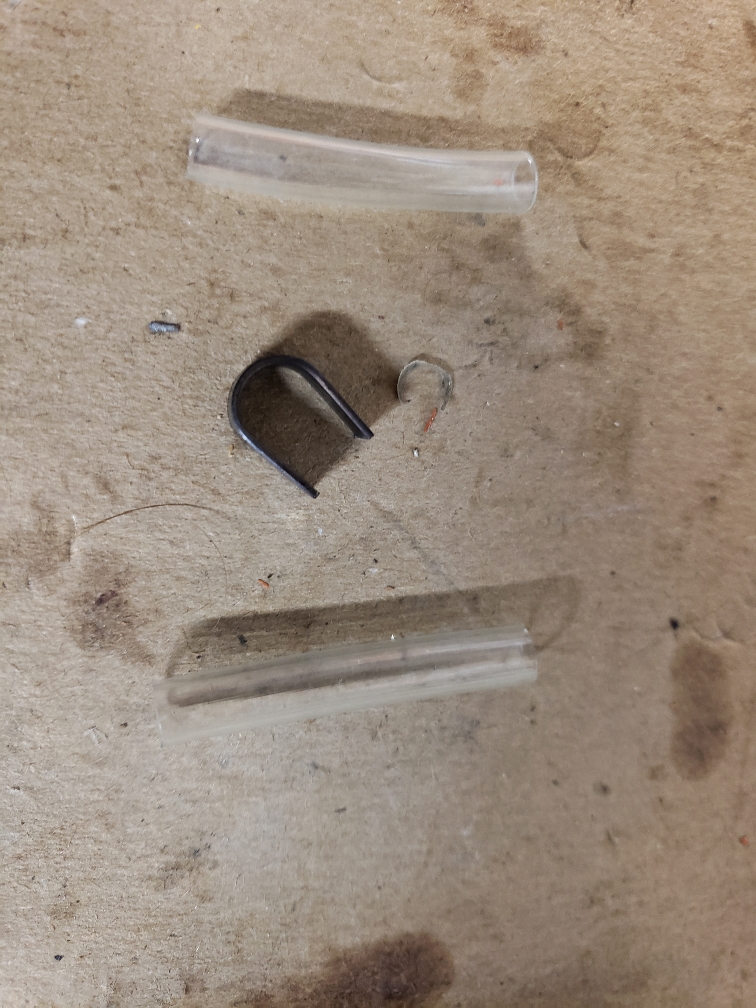

I'm building a 372 and I can't figure out where these parts go. What are they for?

Thanks, that makes sense. What are the hoses for? Something to drive me crazy?

I don't recognize those hoses, they were probably to protect the threads on something.

Are those tubes to large to fit in the carb
Mount holes?
Oem are hard plastic tubes
Believe you are correct, they do not give those little red tubes away. Some one found a tube size that fit.

You guys were both right. Thanks for the help. I had to center the carb with out the tubing on the bolts so the choke would work. Now I don't have to do that.

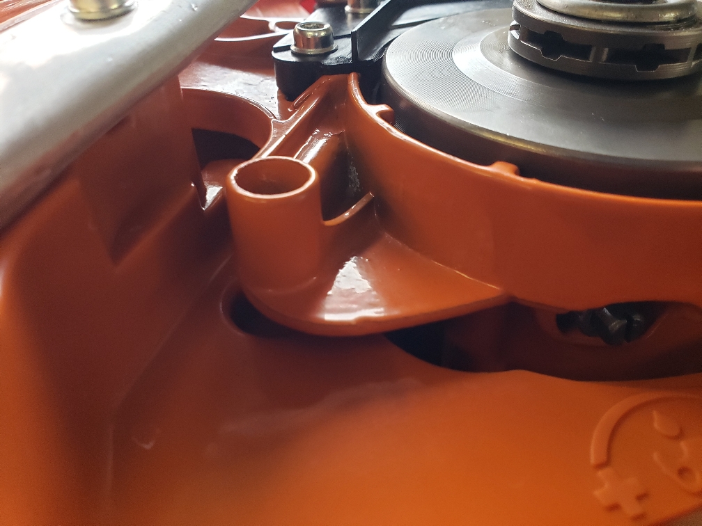

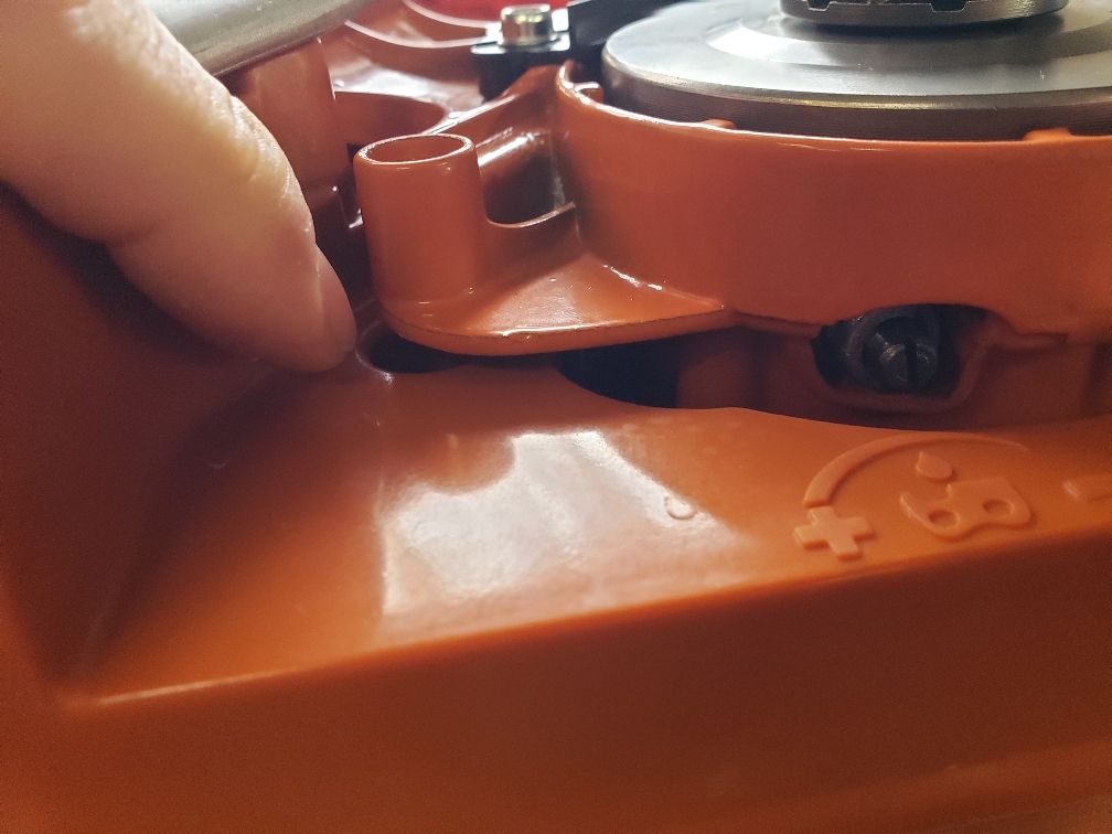

Should there be bushing on the crankcase here? There is a bolt hole there. I am out of bushings.

That is where limiter bolt goes. Bolt with no threads on end of it. No bushing.

Between 4 or 5 models that have those vs how many have fallen off by the time they get to me, I can never remember which ones are supposed to have the rubber bushings on them and which are left without

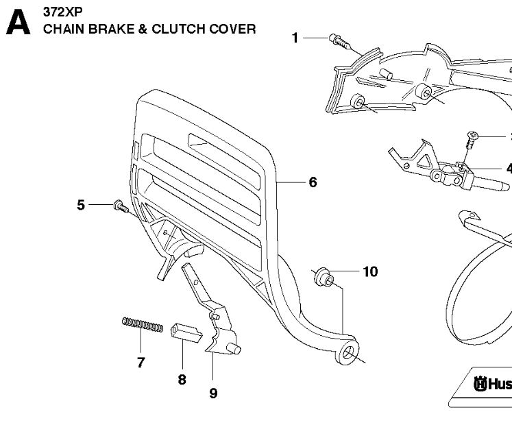

I looked at the ipl when I was putting it together. The IPL showed the bushing, clutch, clutch drum etc. It didn't show the o ring. The o ring is shown with the crank, crank bearings, seals and the bushing is also shown again. The husqvarna ipl is a little weird. Was the o ring already on you bushing?
