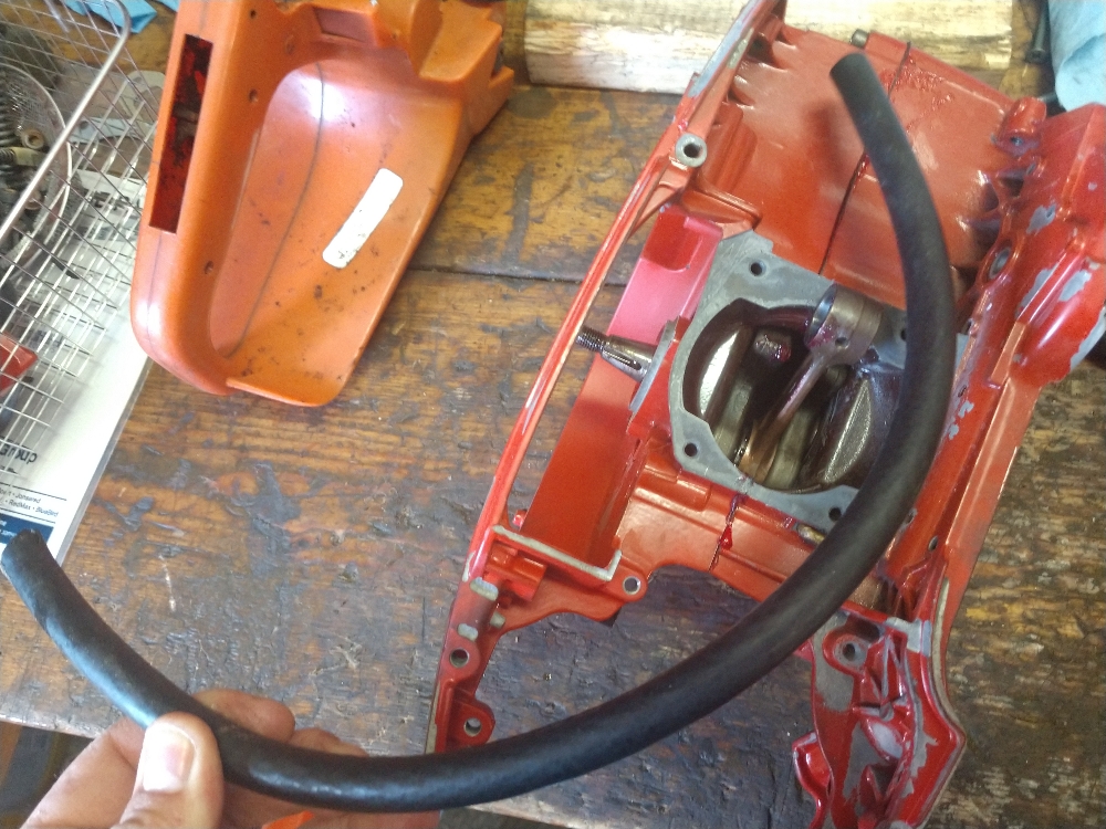

I cannot find them anywhere, no part numbers, nothing.
There are 2 that go in the fuel tank in the holes in the pics .
Not sure if they are even needed as spring mounts are the main support

You do want them. I get them from my dealer.

That's the movement limiter. fuel cap side has its limiter on the crankcase with a rubber band. Other side is a screw.

The rubber band can be made from a hose. You can use a screw that has the right length and fit the thread hole frim the case. Its not mounts. Just movement limiter for the av system.

The limiter screws are part number 503749301. They're available at pretty every online Husky parts dealer but are
usually much cheaper at a brick and mortar dealer. I ordered 30 once and they were able to get them for me for $0.95 each.

The info that I’ve seen shows that they aren’t like the ones on a 390 or 395 with the solid bottom. The ones for 365 actually look like a piece of hose. 3/16 rubber fuel line would be about perfect
