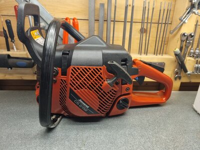

I made a couple of questions about how to build a race saw. And Then I send an email to Canadian farmboy that have build my 440/460 hybrid and I made a pipe for it. I ask him to order all my part, and he send me all tings from Canada to sweden where I live. Here is The list.

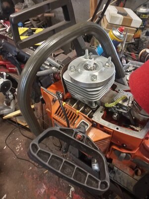

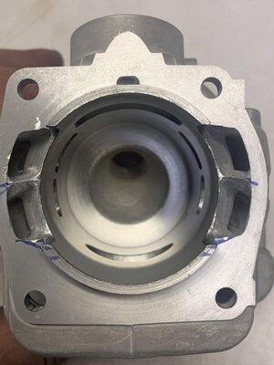

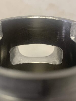

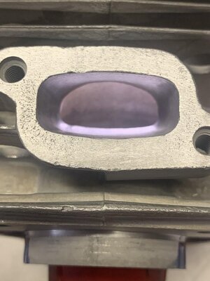

When I receiver all parts I took some measurements. Then send The cylinder back to Canadian farmboy for cuttin squish band, Base and porting. He did a very Nice porting job.

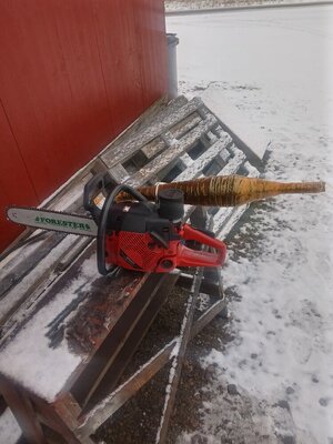

When the cylinder back and a wiseco race piston. I started to put the saw back togheter. And then try to find a pipe for it. I rebuilded the pipe for the engine and put heat wrap and heat resisted tape on it.

I hadent been able to do this build without help from people on the ope forum and especially Canadian farmboy, that fixed all parts and beatiful port work, tanks to all.

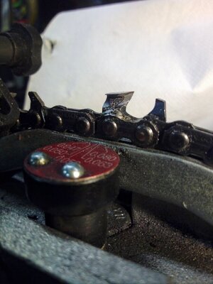

It Will soon be time for testning with a Nice race chain, I made for it. But I need some clean Woods to test it in. Will post more when the Woods is in my place.

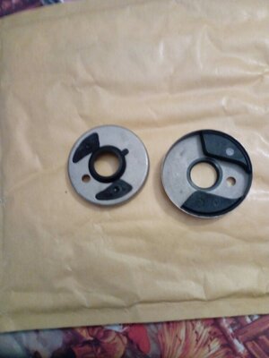

Hello. I dident find any stuffers for my 272. So I made my own.
