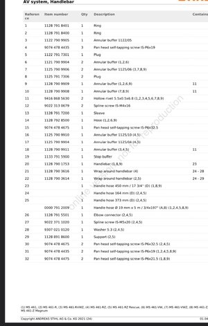

Looking for some solid info on what annular buffers come on 066 / MS660 3/4 wrap handlebar Magnum saws in stock configuration? There are 3 replacement options of soft, normal and hard. I have seen some speculation that some models factory equipped with wrap handles and long bars come with harder durometer AV mounts. Just looking for info of the actual correct replacement Stihl OEM annular buffers for these saws so vibrations and chassis flex stays the same as factory produced. Thanks.

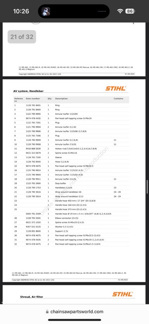

Just looked over the ipl. Stihl doesn't break it down to witch av buffers are on the wrap saws specifically.
The av buffers them selves have identifying number moulded in to them.
Like 1122/22 for the hard av buffer. That has the metal plate that bolts to the pto side case.
Thinking you will have to pull the buffers and check the numbers on them to be sure.Screenshot_20210624-055434.png
