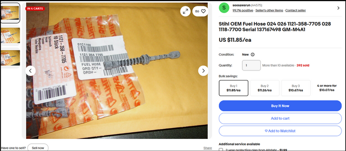

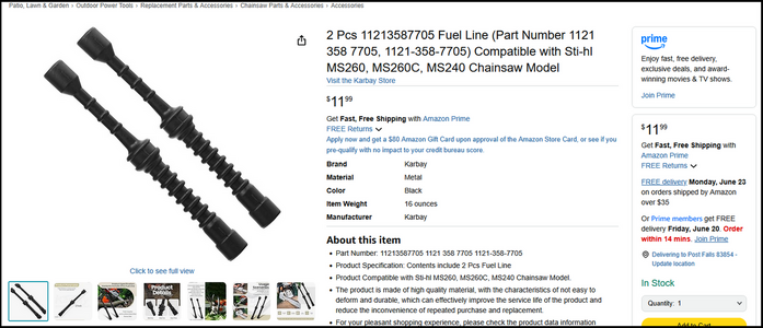

eBay (OEM) or the Zon (AM). You should be able to get away with the 026 option fuel line too as the IPL lists the 11213587705 as an option for both saws. I have used the AM 026 line without issue.

I forgot to add, that I do like the 026 "s" line as it give the fuel pickup a little more reach and makes it easier for it to lay on the bottom of the tank.

Ironically I picked up an OEM 026 hose yesterday. And couldnt help but notice the similarities.
Thank you for solidifying that thought!!
