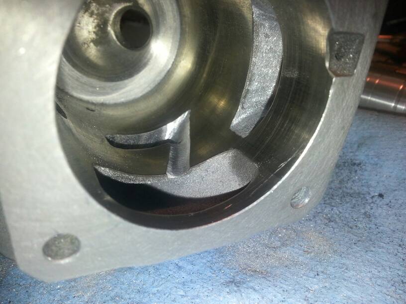

On Bills I did a bridge type combo

I see the difference in angle on the bridge ports. Any reason why one may be better, or doesn't matter?
I have a theory ...but it's just that ...but it looks cool right ???? [emoji2] [emoji2] [emoji2]

It looks very cool! I like theory's... Care to share?
Basically shoot it to the intake side, purging as it goes ....I cannot prove it and I'm probably wrong ...but it sure runs good ...[emoji2]
