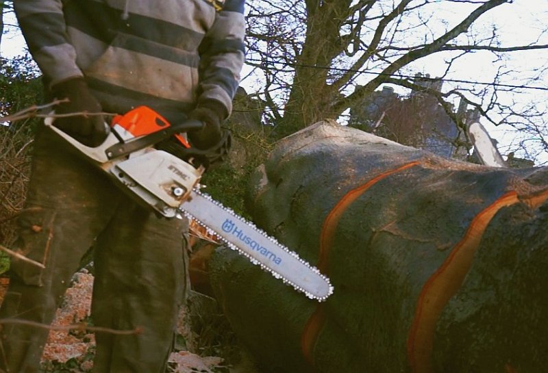

It'll work, but you got to do some grinding and drilling
00wyk
6:42 PM
4606
Nov 16, 2017
1,613
9,214
Ireland
First one is Larch. Second one is spanish chestnut I think. Bar is roughly like a 17" bar. Something like 70-71 links of NK 325 when I got done butchering it.
